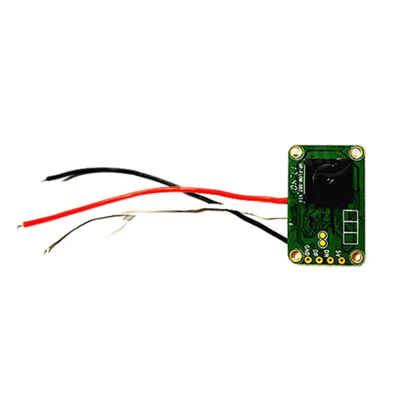

Here is another one :wink:
https://www.aliexpress.com/item/Camera-DIY-Optical-Flow-Module-UP-Flow-LC302-Sensor-Location-Measure-Optical-Flow-Chip-For-FPV/32968961948.html
Another One
@anbello, thanks for that. I’ve added this as a possible alternative on the wiki (it should appear in about 10min).

Here I see ground_distance but on the board I don’t see any range finder, maybe in the microcontroller there is a piece of code that do an estimation similar to that on Ardupilot Flowhold.
I think maybe they will add range finder onboard in future.
