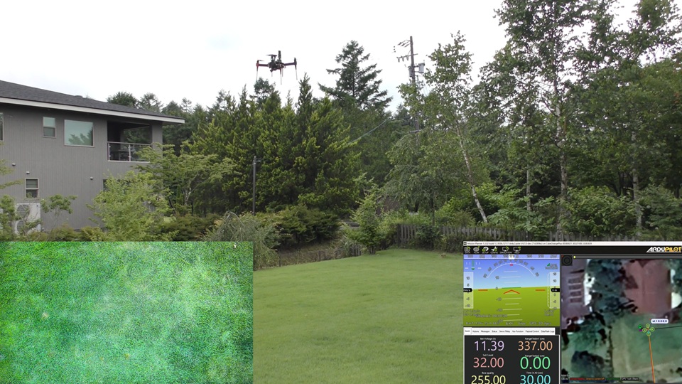

Here are a couple of videos taken recently of new BlueOS extensions for optical flow (wiki) and precision landing (wiki)
You’ll see in the optical flow video that it works quite well up to 17.7m (the limit of the Benewake TFS20-L lidar) although there’s a bit of drift which I suspect it caused by the EK3_FLOW_DELAY’s value of 80ms not matching the actual lag in consuming and processing each image.
A more serious problem is the slightly scary copter movement after yawing about 90deg. This could also be caused by the above mentioned lag or perhaps the camera gimbal’s yaw is lagging behind the vehicle. I think camera gimbals often have a soft yaw response to make the video smoother. I’m fairly confident we can resolve either/both of these issues.
Although performance is not yet perfect, I’m quite excited about the future of BlueOS + ArduPilot because it makes it quite easy for the AP dev team (and anyone else really) to roll-out new features to companion computers in an organised, user-friendly way. We actually have a bit of a backlog of python scripts we want to expose as BlueOS extensions. Next will be:

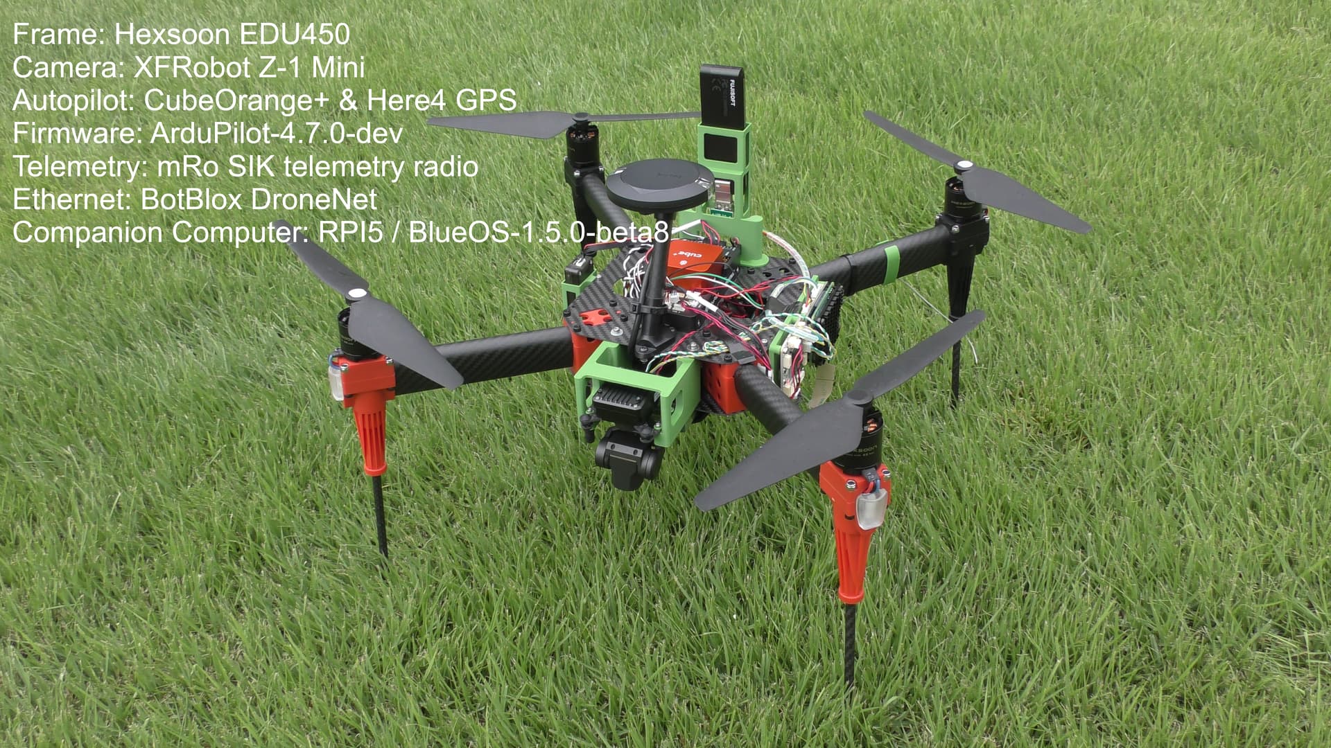

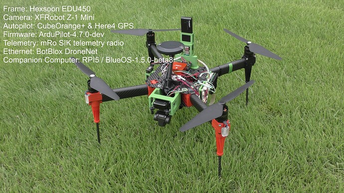

BTW the setup that I used is detailed in this earlier blog post but in short it has these components:

I’ve tested optical flow to 100m and it works pretty well. I don’t know what the altitude limit is but it’s higher than that!

During this test I used an mRobotics 900mHz Sik radio but there is also an LTE modem attached (see the picture at bottom of the original post) which allows the mobile phone network to be used. This is attached to the companion computer directly.

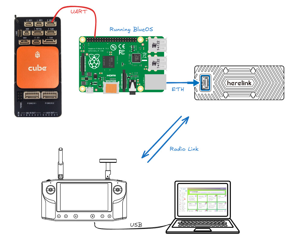

I’ll sketch out a diagram to share what I’m planning—it’s mostly centered around using Herelink Ethernet to bridge video, telemetry, and access to the BlueOS interface.
Thanks again!
Hi @Fonseca,
When I use the mRo SIK radios, the radio is connected directly to the Cube’s serial port and the radios only support sending a single serial stream so communication with the companion computer is not possible.
The connection method you’re suggesting is OK but personally I prefer to connect everything using ethernet instead of a mixture of ethernet, serial and HDMI. Whatever works is fine of course.
