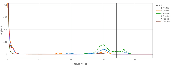

The image below shows an FFT analysis from a flight before applying the appropriate notch filter.
I assumed the peak was at 171 and set the frequency (INS_HNTCH_FREQ) to 171.
However, as shown in the image, there is also a peak occurring around 130.
As you suggested, should I have set INS_HNTCH_FREQ to 148, the middle value between 130 and 170, instead?
I read in the document that INS_HNTCH_REF should be set to Hover_Thrust.
My Hover Thrust is 0.2, but should I set it to 0.11?
Can you explain how to calculate INS_HNTCH_REF properly?
Thank you so much for your help.
Your response is incredibly valuable to me!
The values I specified are carefully calculated from your data.
For throttle-based notch filter the REF value should actually be: INS_HNTCH_REF = hover_thrust * SQRT(min_freq / hover_freq) ← I used this, I have it set up in a spreadsheet
which usually works out to be about: INS_HNTCH_REF = hover_thrust * 0.6 or 0.7
