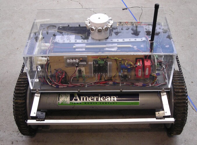

I’ve assumed a compatible base station (e.g., H-RTKF9P Base), telemetry set and power management are included. This is all for upgrading my SODAR-controlled mower to RTK.

Your methodology is flawed.
The Cube Orange+ and Pixhawk 6C are, for all intents and purposes, equivalent hardware. The Cube’s heated and damped IMUs are largely irrelevant for the slow-ish inner control loop utilized by and lack of 6DOF stabilization required by Rover firmware.
The only difference between SimpleRTK2B performance and any other Zed-F9P based system is antenna choice, which you have not specified in the case of the SimpleRTK2B. Practically speaking, though, you could expect identical performance.
Additionally, you’d be hard pressed to note a real, practical difference between UM982 performance and Zed-F9P performance in a Rover use case.
Essentially, given the options presented, choose the price point and form factor that most appeals to you. If you feel you have the skillset to eek every last drop of performance from your system, the Cube Orange+ and pair of SimpleRTK2Bs coupled with survey grade antennas would be VERY slightly preferable.

Thanks much for your insights. I couldn’t figure out the differences between these choices given the reading I have done, and you have answered that question in detail. My reading also suggested that the UM982 was difficult to use. I hoped to solicit answers to the three questions at the bottom from the experience of others in this thread, and you hit on an important one. My skill set in AP is negligible since I haven’t used it yet, and the learning curve appears to be pretty steep. While I’m fluent in C, I hoped to not have to re-develop what I already have in a different environment. Price point for me is last since the time spent debugging eats up the differences pretty fast. With that said, have you found substantial differences in this aspect of getting my straw-men examples to work?
