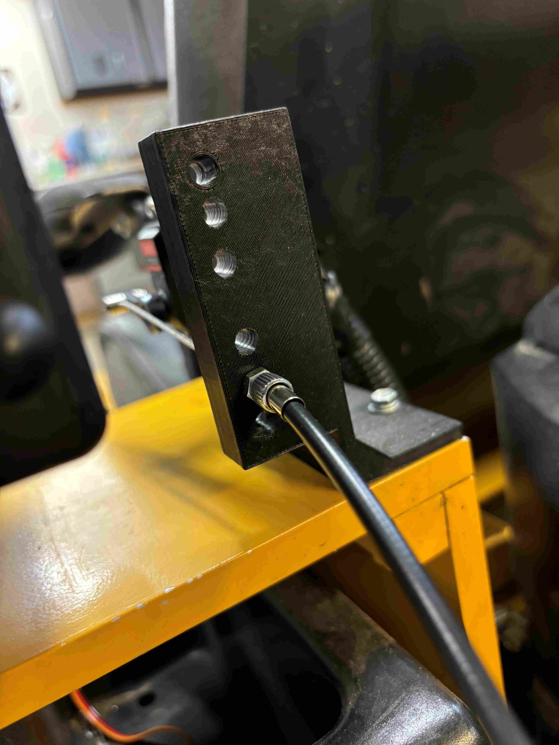

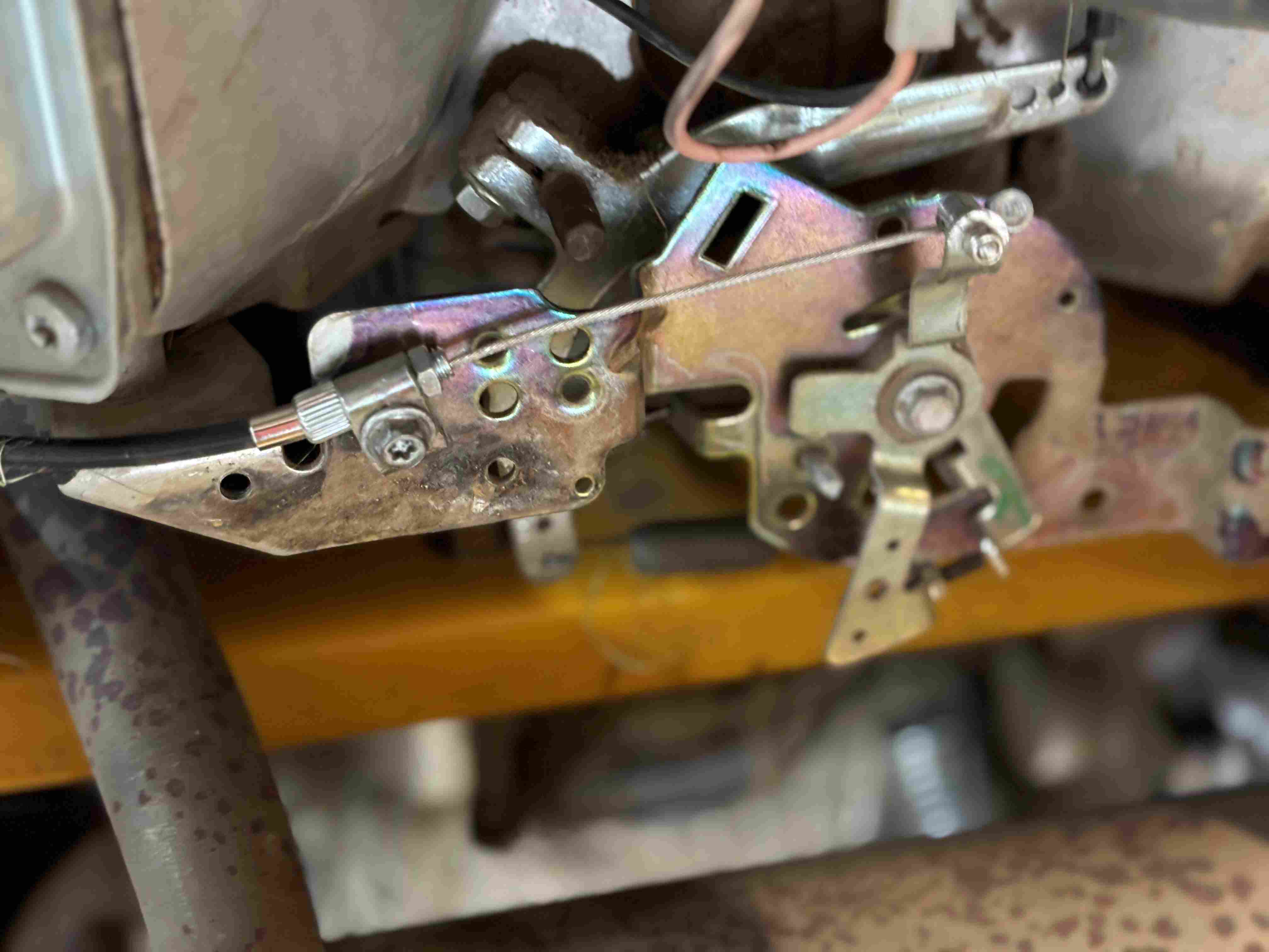

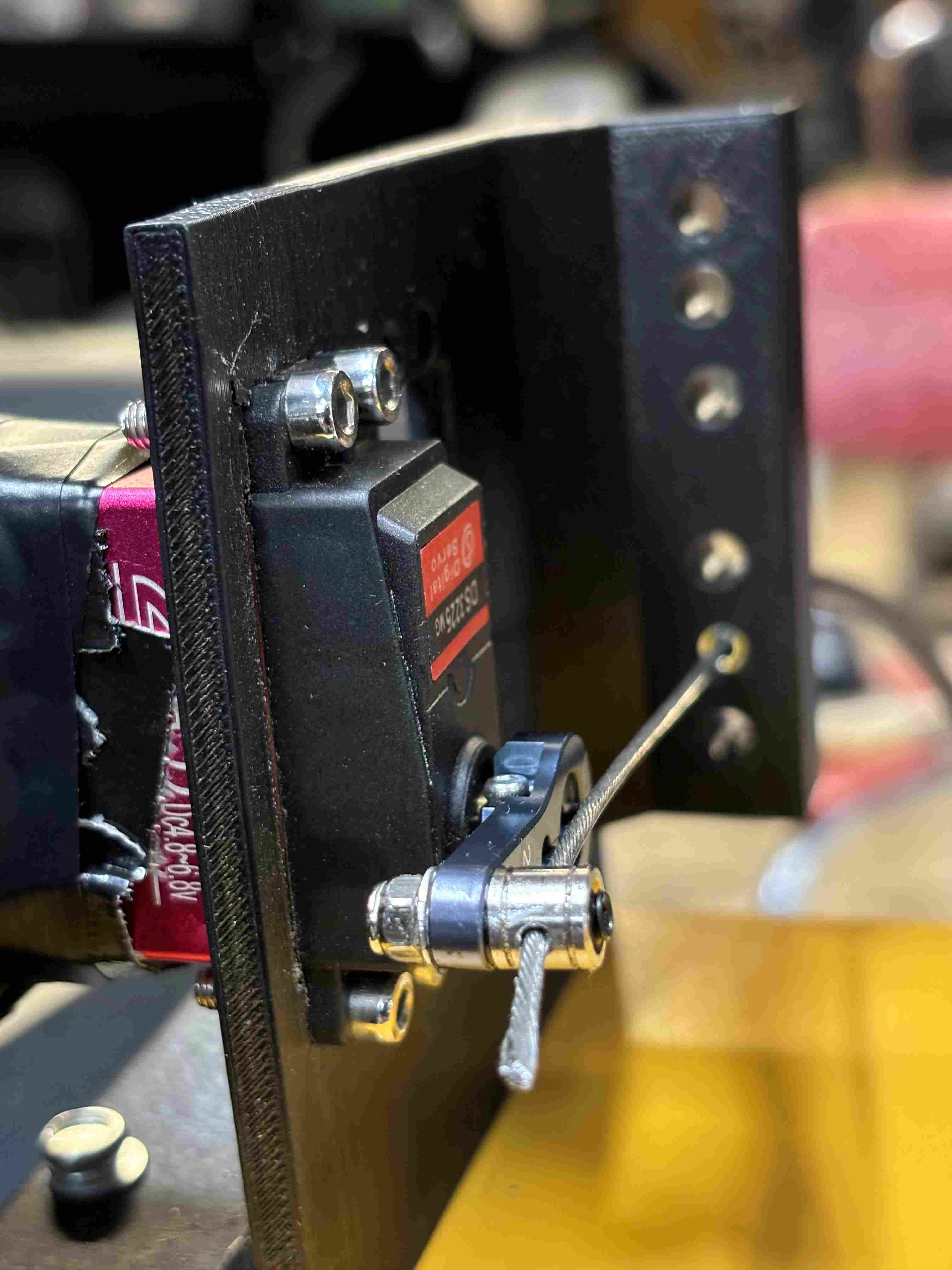

When I was at MowStock this year I learned that other builders were moving the engine throttle and choke servos out of the hot area around the engine. While we were there I worked with @ktrussell to help him make changes to his throttle and choke cable actuated throttle and choke servo system. I thought this approach was clever and since I have also burned out several throttle servos. I decided to make this improvement on my mower and I just wanted to show some pictures in case others are interested. I also wanted to share the list of the parts that we used.
Note: In this view the servo is fully actuated (engine would be at full RPM) and the cable is pulling against the governor spring straight over the center of the servo. The intent is to have no angular torque on the servo while it is fighting with the governor spring under load.
The barrel adjusters on the cable help keep the tension adjusted.
I clamp the cable to the engine by clamping on one of the barrel adjusters so I do not crush side wall of the cable. I crushed one cable before I realized how fragile they were.
List of parts:
SHIMANO Universal Standard Brake Cable Set
https://a.co/d/fCMpRLK
6mm Bicycle Brake Caliper Barrel Adjusters
https://a.co/d/6gqr78j
BQLZR Stainless Steel Servo Push Rod Connector
https://www.amazon.com/dp/B018S87QAM?psc=1&ref=ppx_yo2ov_dt_b_product_details
DS3225MG 25KG 180° Waterproof Metal Gear High Torque Digital Servo
The servo is nothing special. It is small, cheap, and it works for me.
Also many thanks to @ktrussell for giving me the 3D printed servo mounting bracket!
It was funny because when were there @Swebre2023 took one look at my throttle servo and said that thing will not last where I had it mounted near the muffler. Well, it burned up and that is when I decided to go ahead and implement the cable approach. My mower has the carburetor mounted right over the muffler (too close for comfort). This maximizes my chances for it burning up if I get a fuel leak and it makes it hard to mount anything near that area.
Looks great, Steve. I think that even though we install the servos in a way that keeps the torque low at full throttle as you show here, the small servos can’t handle the force pulling on the shaft sideways.
I’m replacing my rotary servo with a small linear actuator. I’ll report back when I get it installed.
Not that anything is wrong with moving the servos to a less severe environment, but both my choke and throttle servos have been going strong for about 2 seasons attached via a custom bracket near the carb, not far from the right exhaust port. I don’t necessarily advocate that approach, but it has been effective for me.
My throttle servo was always too hot to touch and didn’t last. My mower does not have a shield of any kind above the muffler. I have noticed that some do. That could makeva significant difference.

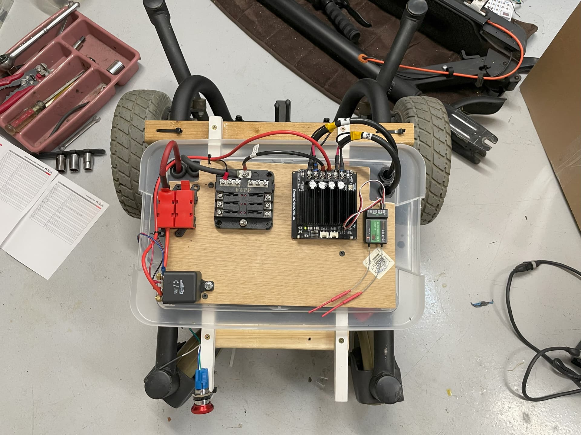

  1. The mower will be built around a 20" 56V EGO push mower that had the smoke leak out of the controller. But i’m not going to work on the mowing bits until i feel good about the controls and safety features.
  2. Until then i’ll use the Invicare 140 mobility chair base shown.
  3. DTXMX Flysky FS-i6X 10CH Radio Transmitter and Receiver FS-iA10B 2.4G RC
  4. Cytron Motor Driver 30Amp 7V-35V DC 2 Channels SmartDrive Dou MDDS30
  5. the two 12v SLA Batteries are wired in parallel after the original 24v was a bit too fast even with Cytron configured in exponential control mode.
