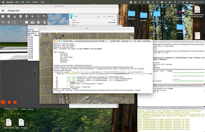

I am trying to following this simple intro guide so that make my zephyr run.
I am on MacOS M4.
In my terminals, I run:
  1. sim_vehicle.py -v ArduPlane -f gazebo-zephyr --map --console --model JSON --debug --lldb --speedup 1
  2. gz sim -g
  3. gz sim -s -r -v4 zephyr_runway.sdf
But I am getting this result on one of the windows
Here’s the lldb window:
as you can see it gives me this response:

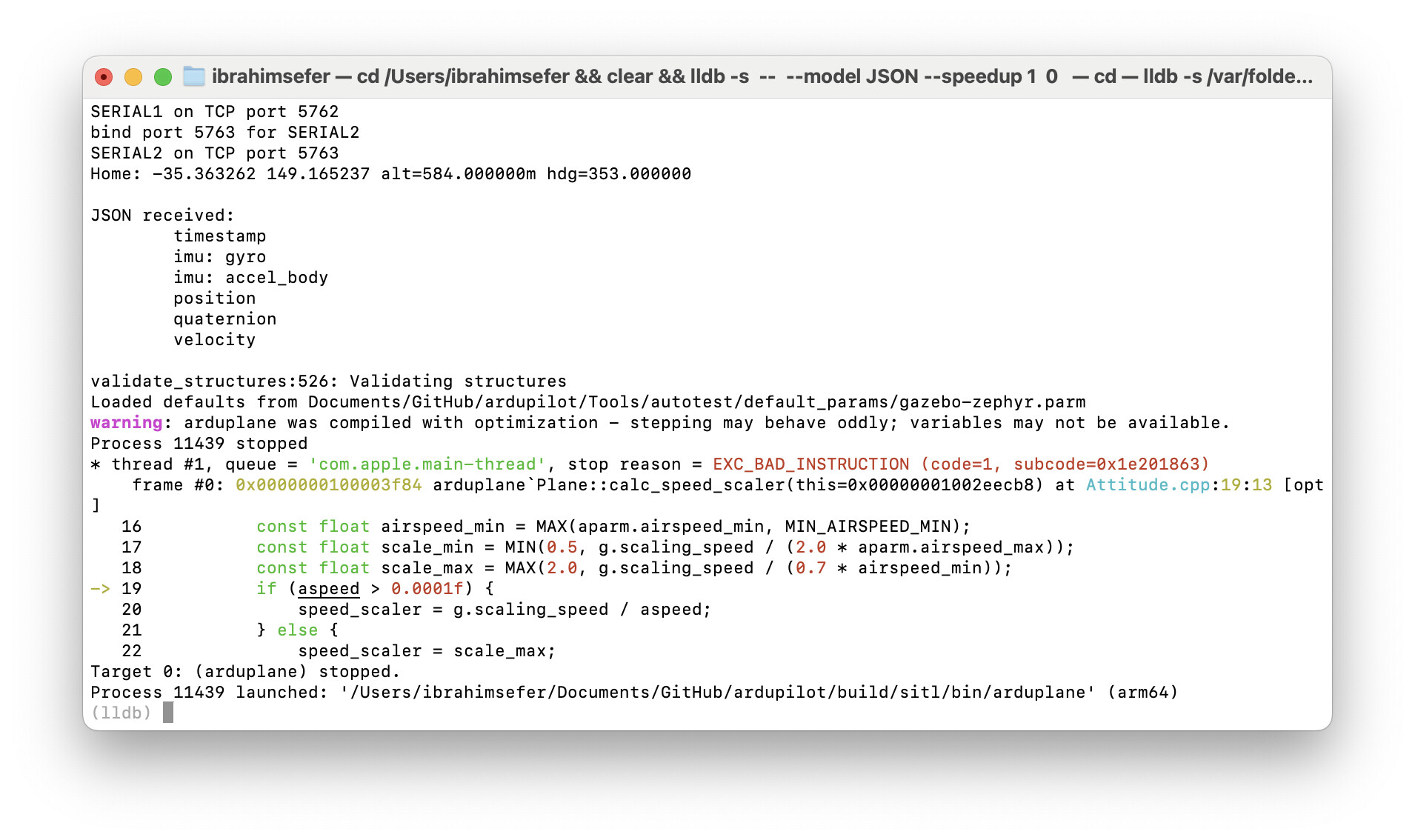

(lldb) target create "/Users/ibrahimsefer/Documents/GitHub/ardupilot/build/sitl/bin/arduplane"
Current executable set to '/Users/ibrahimsefer/Documents/GitHub/ardupilot/build/sitl/bin/arduplane' (arm64).
(lldb) settings set -- target.run-args  "--model" "JSON" "--speedup" "1" "--slave" "0" "--defaults" "Documents/GitHub/ardupilot/Tools/autotest/default_params/gazebo-zephyr.parm" "--sim-address=127.0.0.1" "-I0"
(lldb) command source -s 0 '/var/folders/_c/dylw2htx35b_nsyqp43w3nl00000gn/T/tmp30o4w__s'
Executing commands in '/var/folders/_c/dylw2htx35b_nsyqp43w3nl00000gn/T/tmp30o4w__s'.
(lldb) process launch
Setting SIM_SPEEDUP=1.000000
Starting SITL: JSON
JSON control interface set to 127.0.0.1:9002
Starting sketch 'ArduPlane'
Starting SITL input
Using Irlock at port : 9005
bind port 5760 for SERIAL0
SERIAL0 on TCP port 5760
Waiting for connection ....
Connection on serial port 5760
Loaded defaults from Documents/GitHub/ardupilot/Tools/autotest/default_params/gazebo-zephyr.parm
bind port 5762 for SERIAL1
SERIAL1 on TCP port 5762
bind port 5763 for SERIAL2
SERIAL2 on TCP port 5763
Home: -35.363262 149.165237 alt=584.000000m hdg=353.000000
JSON received:
	timestamp
	imu: gyro
	imu: accel_body
	position
	quaternion
	velocity
validate_structures:526: Validating structures
warning: arduplane was compiled with optimization - stepping may behave oddly; variables may not be available.
Process 11439 stopped
* thread #1, queue = 'com.apple.main-thread', stop reason = EXC_BAD_INSTRUCTION (code=1, subcode=0x1e201863)
    frame #0: 0x0000000100003f84 arduplane`Plane::calc_speed_scaler(this=0x00000001002eecb8) at Attitude.cpp:19:13 [opt]
   16  	        const float airspeed_min = MAX(aparm.airspeed_min, MIN_AIRSPEED_MIN);
   17  	        const float scale_min = MIN(0.5, g.scaling_speed / (2.0 * aparm.airspeed_max));
   18  	        const float scale_max = MAX(2.0, g.scaling_speed / (0.7 * airspeed_min));
-> 19  	        if (aspeed > 0.0001f) {
   20  	            speed_scaler = g.scaling_speed / aspeed;
   21  	        } else {
   22  	            speed_scaler = scale_max;
Target 0: (arduplane) stopped.
Process 11439 launched: '/Users/ibrahimsefer/Documents/GitHub/ardupilot/build/sitl/bin/arduplane' (arm64)
(lldb)

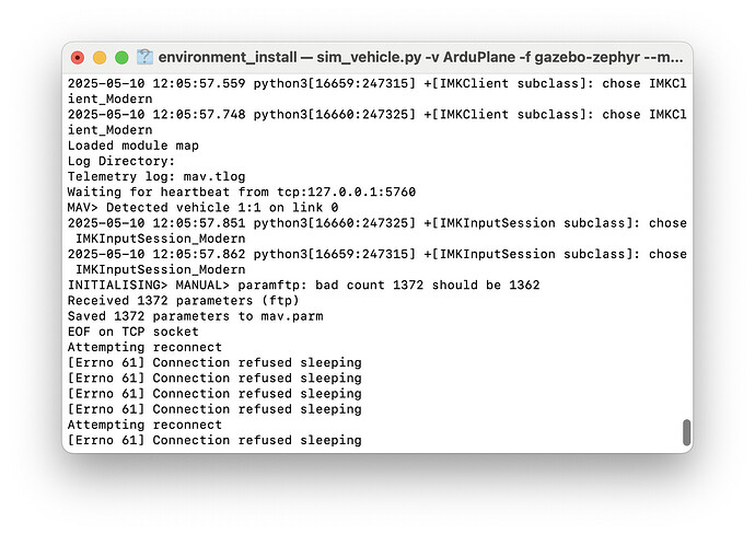

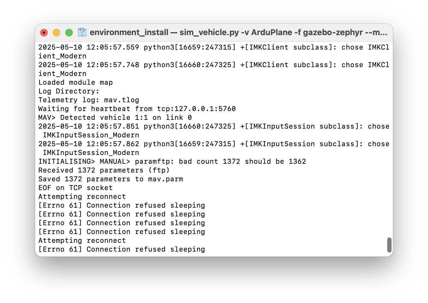

As soon as this error is displayed, the no link gets displayed… It just disconnects…
Hopefully, someone is able to help me!
Here’s the full window display if it’s helpful:
P.S. I will tag you @timtuxworth because you had a very similar issue, so maybe you are encountering this issue right now, or maybe you have even solved it?

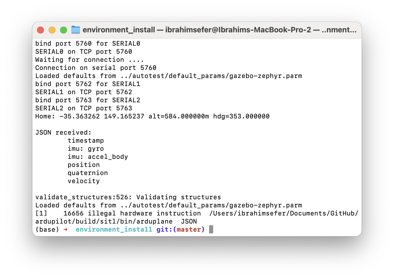

If I run it without --lldb I get this:
[1]    16656 illegal hardware instruction  /Users/ibrahimsefer/Documents/GitHub/ardupilot/build/sitl/bin/arduplane  JSON
And in the sim_vehicle.py ... terminal window, I get this:
Hopefully this added some more context…

@Sefibrah can you replicate the illegal instruction error on a standard SITL session? i.e. no Gazebo, just a copter or plane.
sim_vehicle.py --debug -v ArduPlane -f plane --console --map
with and without the debugger.
Also, which version of macOS and Xcode is installed (and any other system info that might be relevant).
