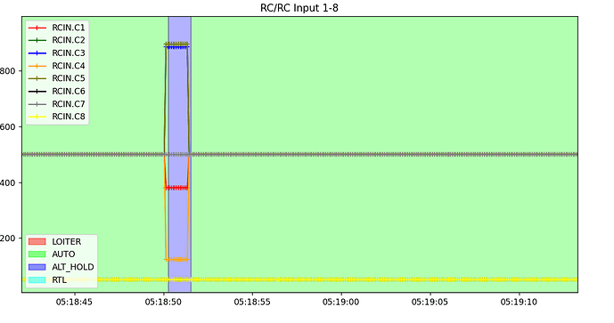

I had few incident where my mode automatically changes to some random mode once the communication is lost.
I am not able to understand the logic behind it. I have not programmed it anyway. I was just doing some random flight test, it does not happen in all flights. It happens only in some flights randomly.
Is there anyone who can help me to find the issue? Here is the flight log: 2025-03-30 16-37-25.bin - Google Drive

RC 5 (your flight mode channel) changed.
So the drone did what it was told. I suggest you look at how you have your radio failsafe set on the radio. What kind of radio system are you using?
The same moment the quad changed to Alt-hold, several other channels all jumped to some very arbitrary values. To me this looks like an old-school RC failsafe routine. Either way, I’d say this is a radio problem, not an Ardupilot problem. If you describe your radio and hardware set up we might be able to give you more specifics on what to look for.

I think this is more of a FC or receiver problem, as when this happens the drone was not connected to Radio, so I don’t know from how somehow receiver jumps all the channel signals to some random values. How can we check whether this signal was given by FC or not?
The graph I plotted was what the FC is seeing from the receiver. Again, the FC did what it was told to do. So I still feel this problem is in the radio setup (I’m including the receiver as part of the radio)

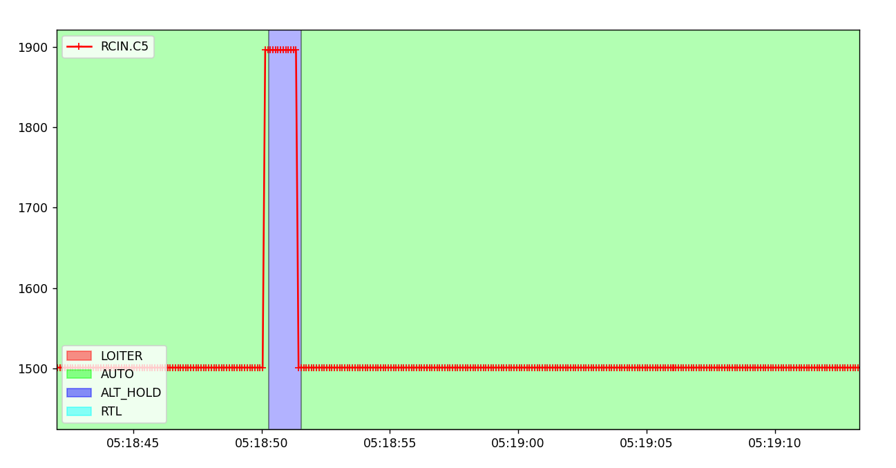

I see in your pictures channel 5’s failsafe is 1300, but reverse is checked. So that would seem reasonable why it went to flight mode 6 based on your parameters.

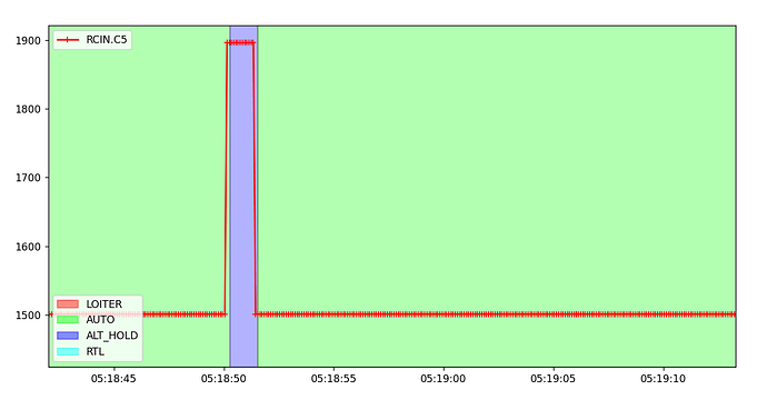

True but in some other flight it went to value of 1900 and channel 1 to channel 4 went to some random values not 1500 in the event of radio failsafe.
Based on what you’re saying I’m not sure what to recommend if the radio is doing “random” things. My only viable suggestion would be to consider looking into a newer radio system that is more reliable. You can get some good ELRS systems for little money, and now ELRS has the ability to do Mavlink it’s a good option.

This is one flight where all channel went to some random stuff during communication lost. Even though the failsafe value for Channel 5 is 1300 but in this flight Channel 5 jumped to 1900 value.
So hard to trust my current radio.

I suspect it’s because you have channel 5 set to reversed.

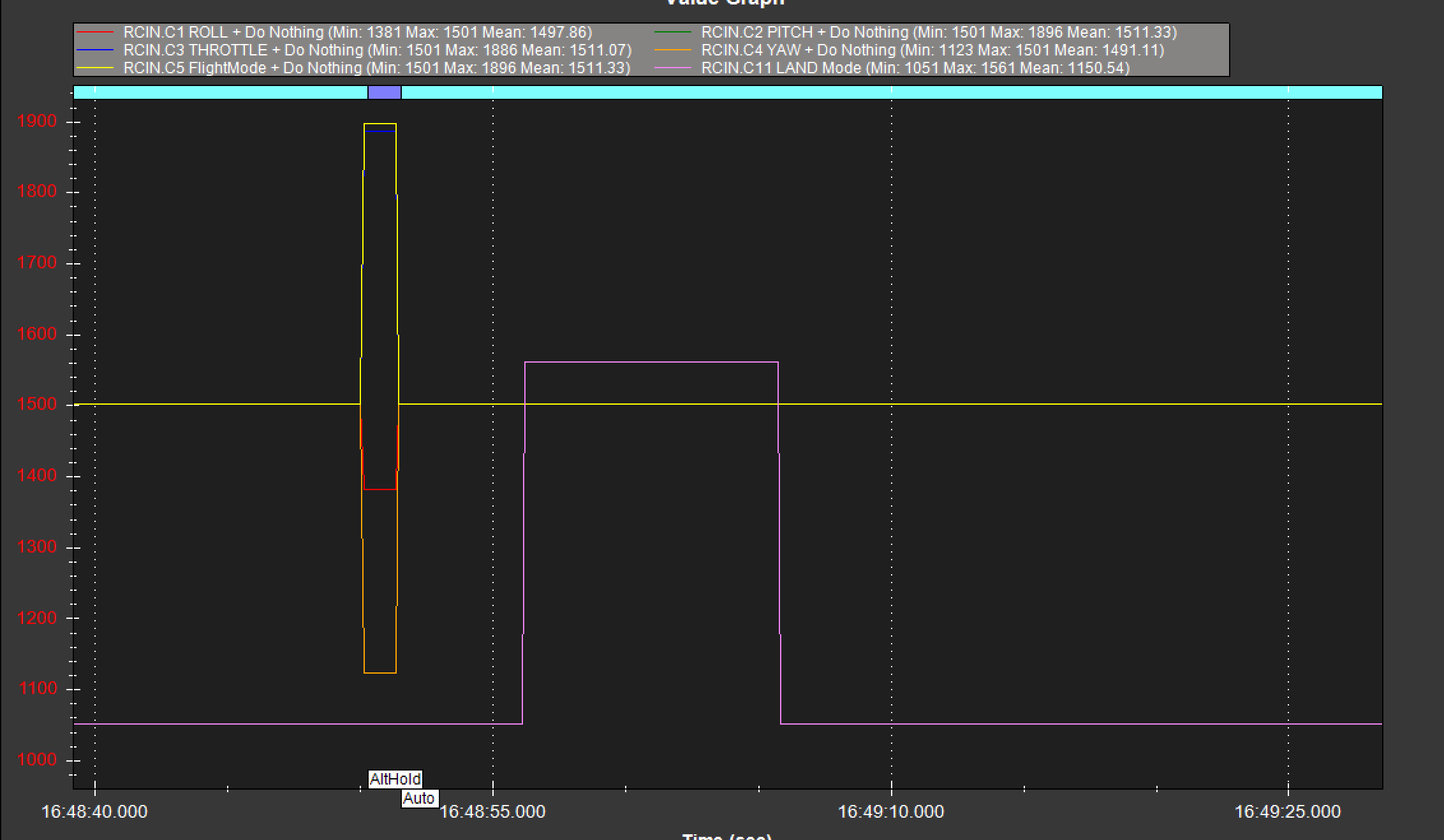

This is also one log which I want you to look: 2025-03-31 10-25-41.bin - Google Drive
Here if you see, the channel 5 switches to 1300 as it was set to 1300 failsafe in RC setting.
But in the other log which I shared above, same channel switched to 1900.
I know it is strange, just want to know whether this somehow makes some sense to you or if you can give me some logic behind changing the PWM by receiver.
The more I see of this radio, the less it makes any sense.
I would test on the ground what setting the failsafe to 0 will do. I won’t recommend turning off failsafes, and I don’t know the behavior of this radio to even predict how it will react.
If you have the RC failsafe set on Ardupilot then if the radio failsafe is triggered Ardupilot will ignore the random outputs form this radio. It might be a pain, but it will be less pain than watching your drone crash.
