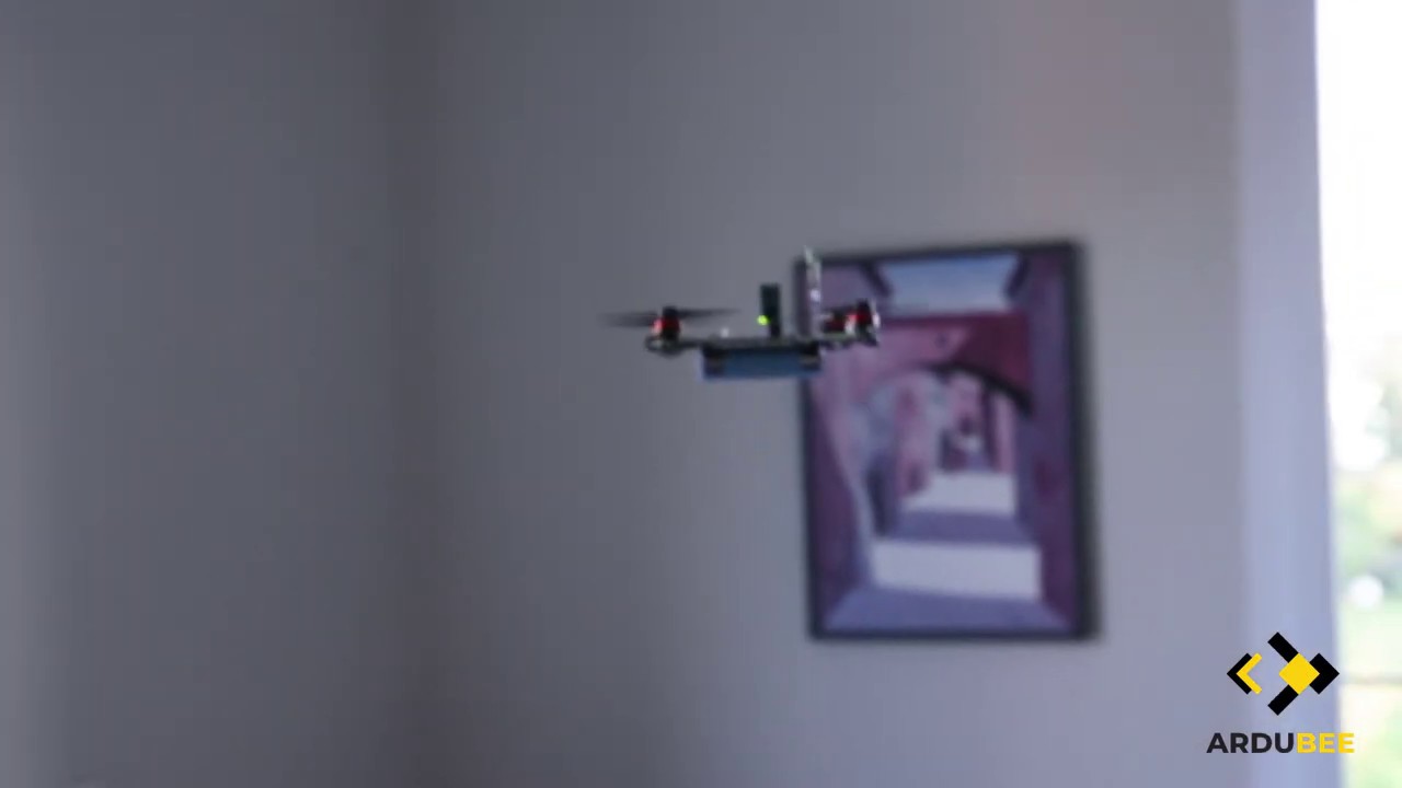

MAIDEN FLIGHT
Here’s a brief video of the ArduBee-0.2 maiden flight!
ArduBee is flying nicely in the air and only a slight, subtle humming can be heard.
I’ve just made a quick first gyro’s filtering with the basic throttle method for the Harmonic Notch filtering (thanks @anypiper), the PIDs are not yet tuned at all!
It has the main noise peak at 236Hz, this is the graph post filtering
