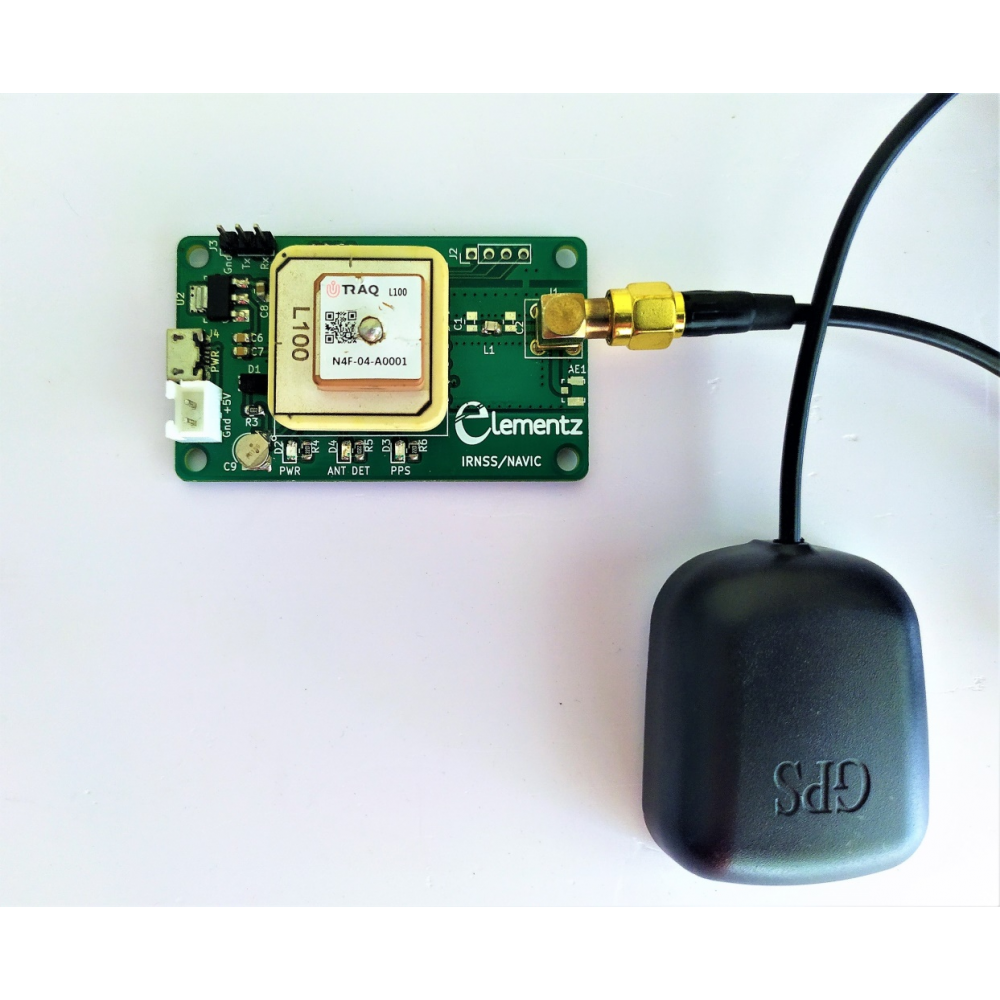

@rishabsingh3003 @count74 Sir can we use the below GPS module for our ardupilot?
The description says the module uses NMEA and has a UART. This should qualify the GNSS module to work with ardupilot. Since I never used it and it is not mentioned in the ardupilot documentation, I can not confirm that it really works. You will have to try for yourself, or wait if someone else has used this module successfully with ardupilot.
