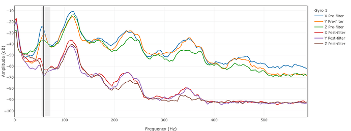

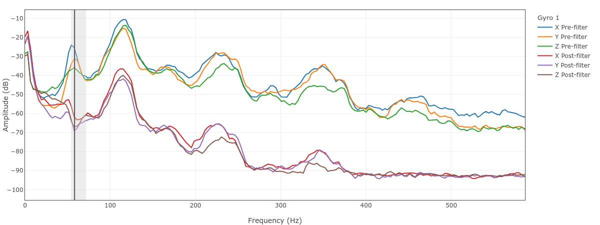

Regarding the filtering, you should enable also the 2nd harmonic as it is the most prominent on your machine.

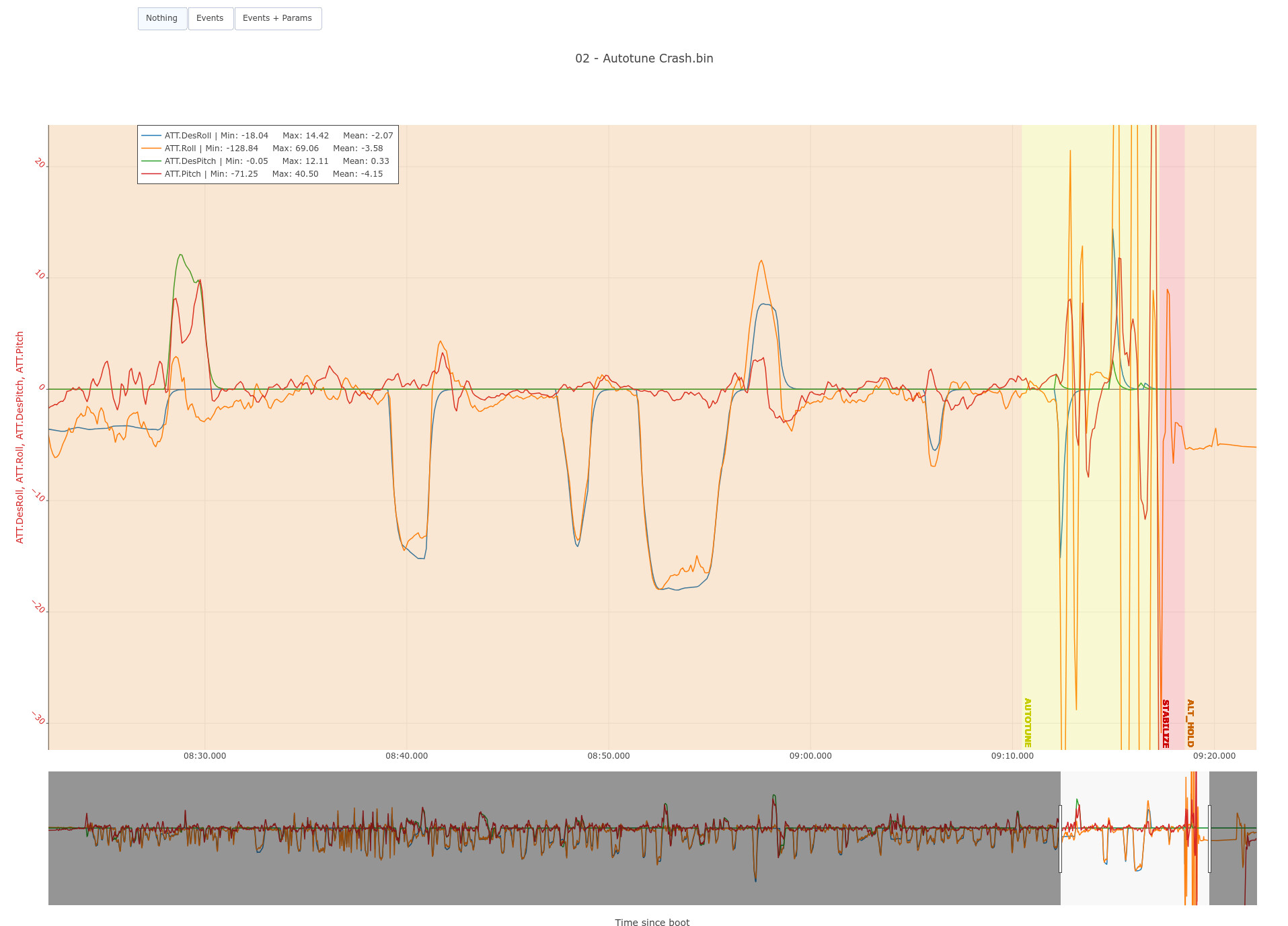

But this is not the reason for the crash. I conjecture it’s the initial tuning, which is too sloppy to recover from strong deviations. The reaction to your inputs in AltHold at 8:28 in roll and 8:58 in pitch, among other, suggests me this interpretation.

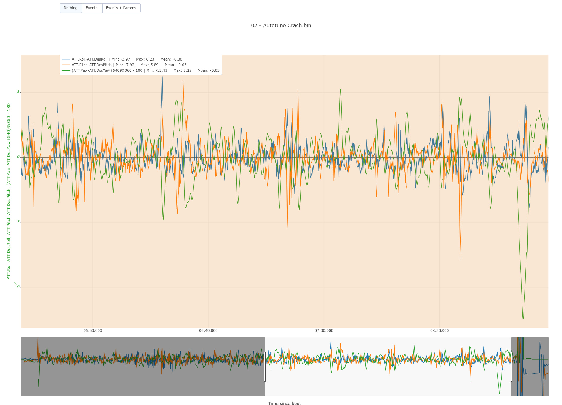

This is a larger machine than I mainly work with, but I only enter autotune if I am reasonably sure the machine can handle it, which I would not say for your case. Your machine, in my opinion, needs a bit more manual tuning, which in your case, based on in-near-hover angle deviations:

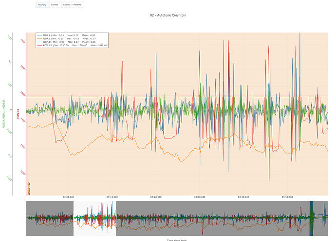

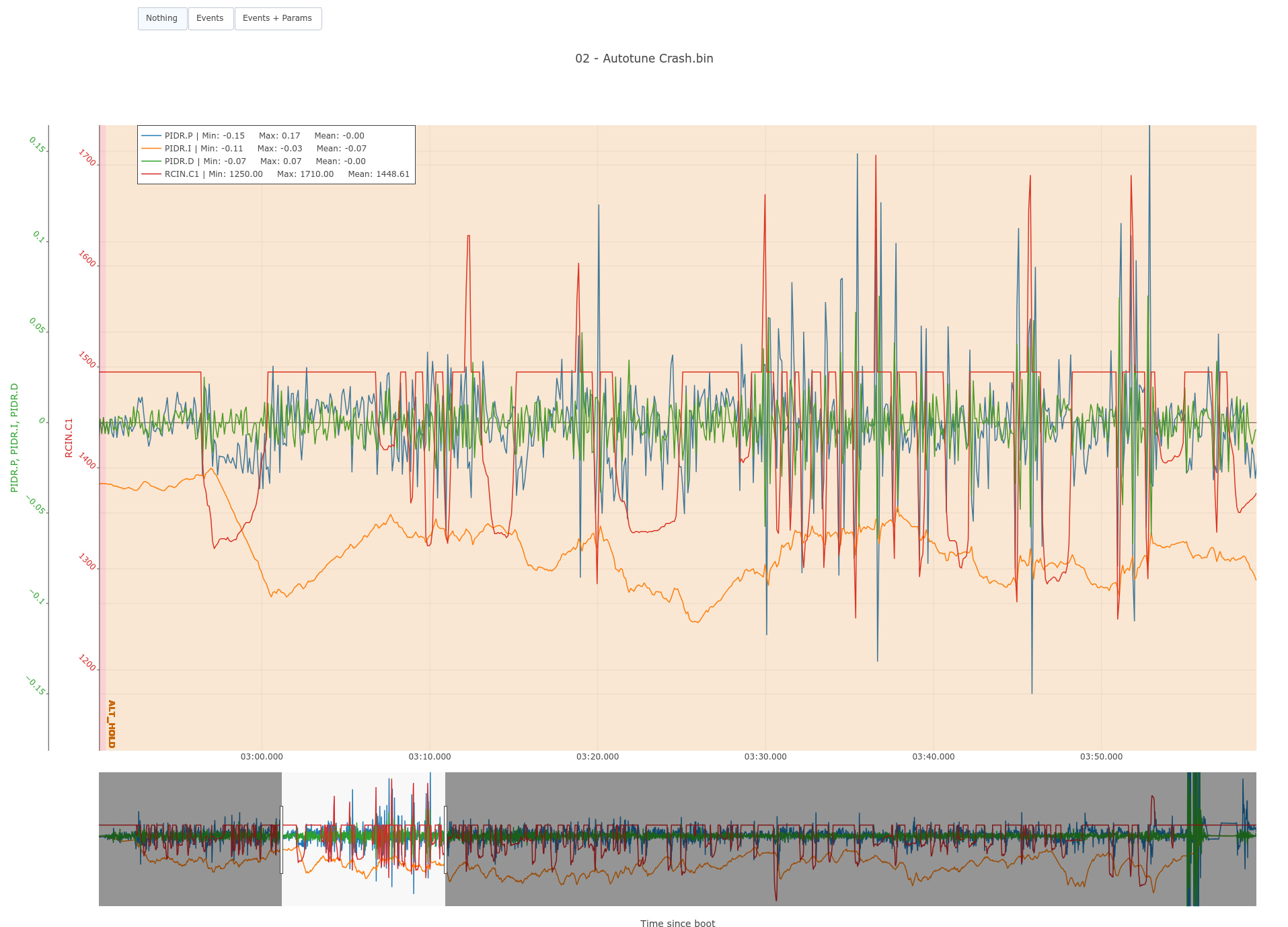

and corresponding PID contributions (roll as an example):
rather requires a proportional increase of rate P, I and D. I would probably start at a factor of 1.5 - but only after notches are fixed as noted above.

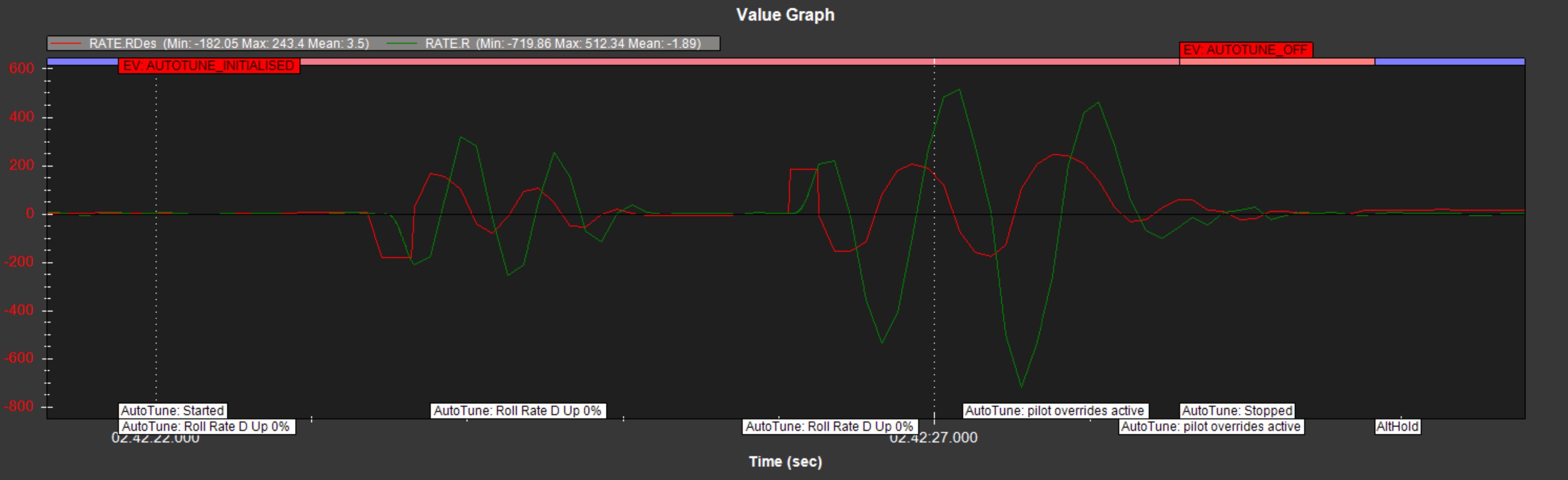

The angular acceleration measurements during the two autotune twitches also suggest increasing ATC_ACCEL_{R,P}_MAX by a factor of about 2. The measured acceleration was reported to be about 100k in the units of AC 4.6. A too low value here results in the machine very reluctant to perform sharp output changes, which might have contributed to recovery from the twitches.

Agree with this. There is not enough attitude authority with the Rate PID’s set. Look at this reinforcing Roll oscillation.

Vibe entries look not extremely bad for first two IMUs (VIBE[0], VIBE[1] are generally within 4-8 for X and Y, and within 10-20 for Z) but quite bad for the third one (VIBE[2] are all 20-50). The third one, if I remember correctly, is the one not internally dampened in CubeOrange. To me, this is an indication that you want to improve your assembly. The peak -10 dB of raw noise (in my machines it’s below -30, which is a huge difference) at 2x the motor rotation frequency, aka one hit per prop blade, suggests that this has something to do with the frame arm mount rigidity, but it is very difficult to decide correctly from logs alone.
Roughly 1/5 of the frequency with four notch sources is correct to my eye. (The bandwidth is not 10Hz, it’s 10/54-th (that is, INS_HNTCH_BW/INS_HNTCH_FREQ) of the real reported motor rotation frequency)
