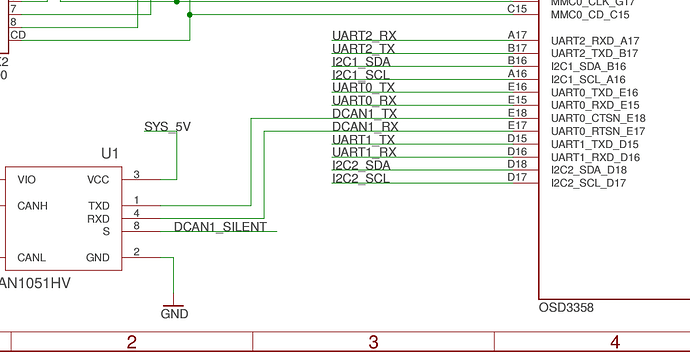

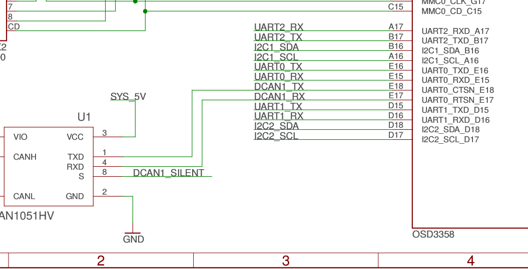

I have been struggling to get CAN working, am i reading this correct that the CAN port is connected to UART0? I might have to get creative with the serial ports.
do you think this would work on it for monitoring the operating system while Ardurover is running?
It looks like the CAN port repurposes UART0’s flow control pins.
It would then reason that someplace in a definition file, you can either enable UART0 flow control or CAN, but not both.
ok so you think its just using the flow control pins and not the actual port uart0?
I have it in my rover, i found enough wire in my spares box to get the esp32 and mavlink splitter connected, i have the wheels moving, I still need to figure out RC and CAN but i need wires to arrive first.
That’s how it reads. Pins E17 and E18.
I just mean is it going to disable uart0 if I use it?
I don’t think so. But I don’t know so…
