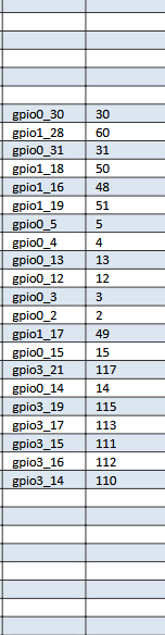

GPIO is mapped here

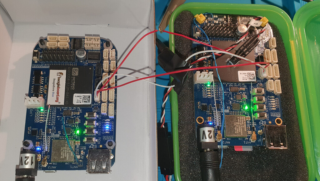

@juvinski I have copied this post here, I am waiting for some wires before i can test it.
perhaps you can answer this question? is the CAN port tied to UART0?? or is it just using the flow control pins?
Hi @geofrancis ,
The simple answer is the CAN is using just the flow control pins - generic names in this case, if I’m talking about very basic things, but all devices in the beaglebones are defined by the device tree overlay file.

Good news!!
CAN is working!

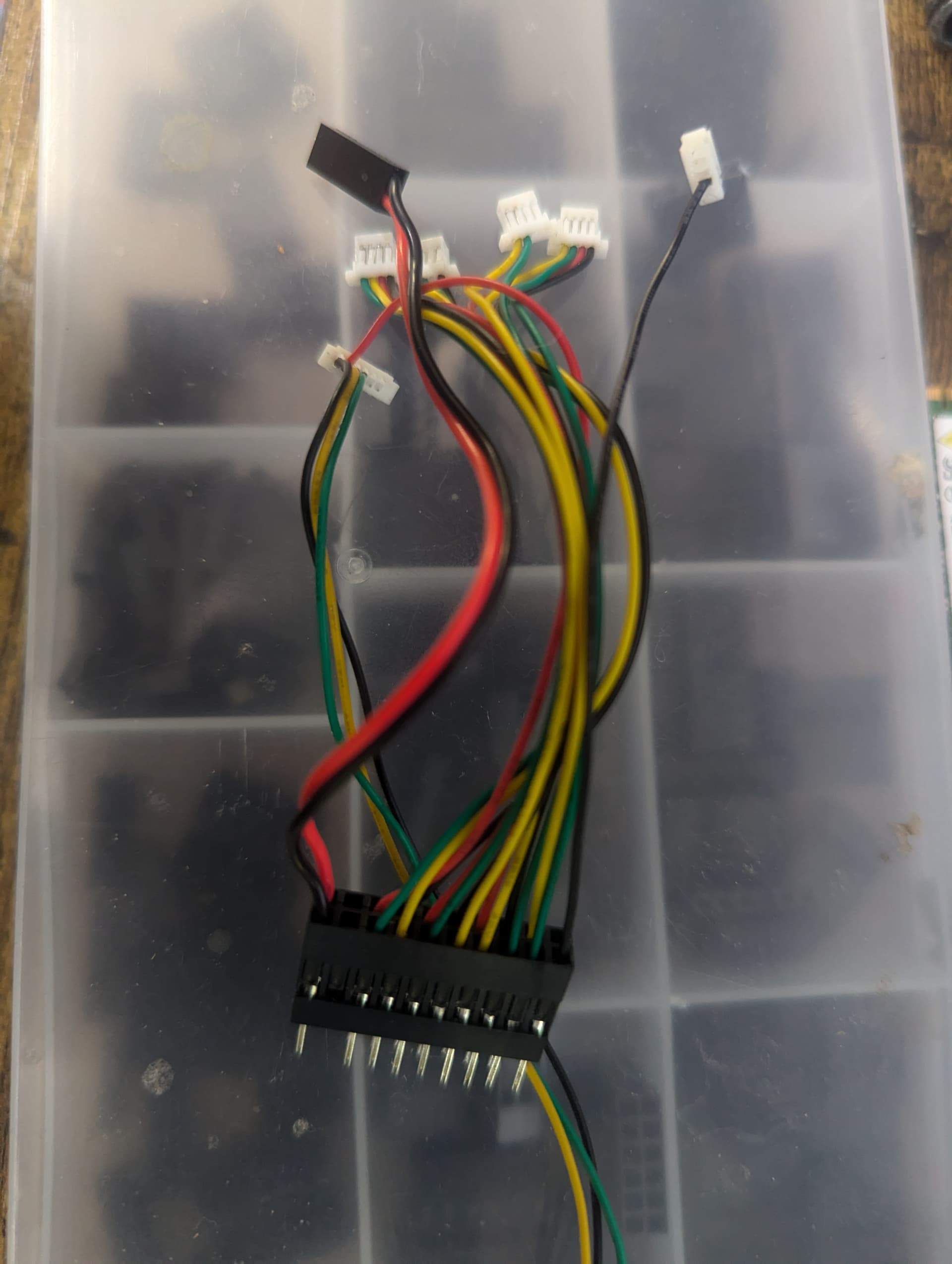

Rather than trying to deal with potentially damaging the 1.0mm connectors I just added them onto a big servo style block with all its connectors that I can just leave attached.

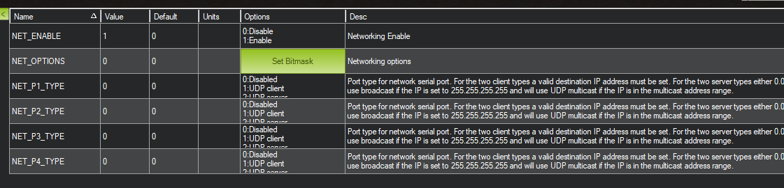

Setting the UDP IP to 255.255.255.255 lets any computer connect from any ip.
# WiFi Telemetry
SERIAL0="-A udp:255.255.255.255:14550"

also discovered since its a linux flight controller its compatible with all the cool networking features being added.

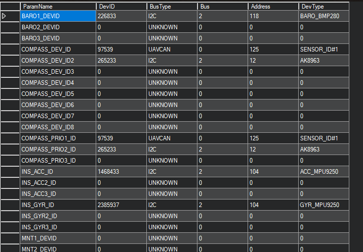

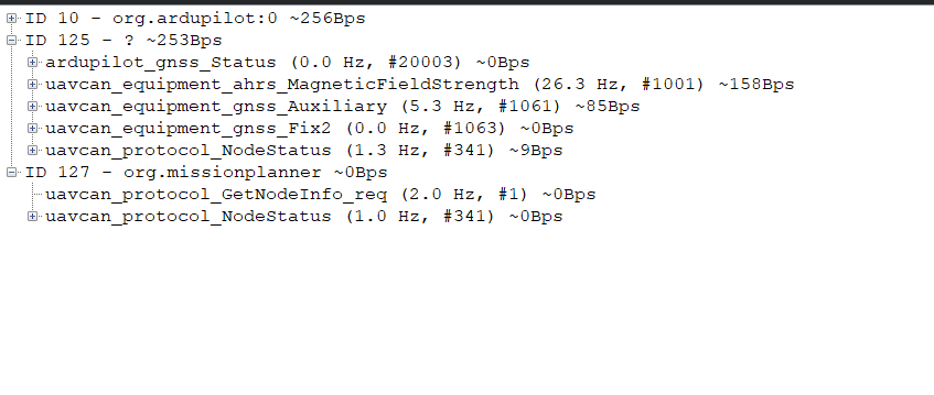

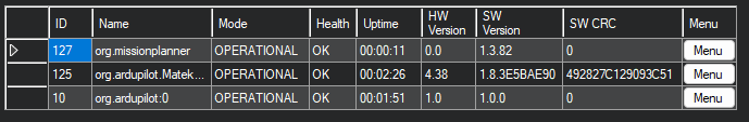

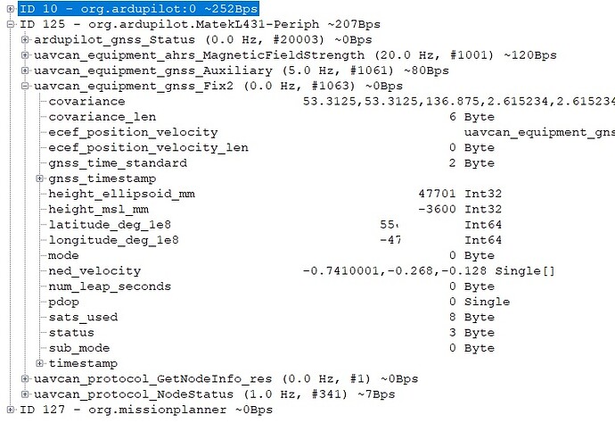

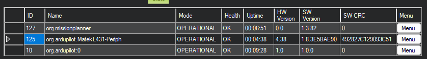

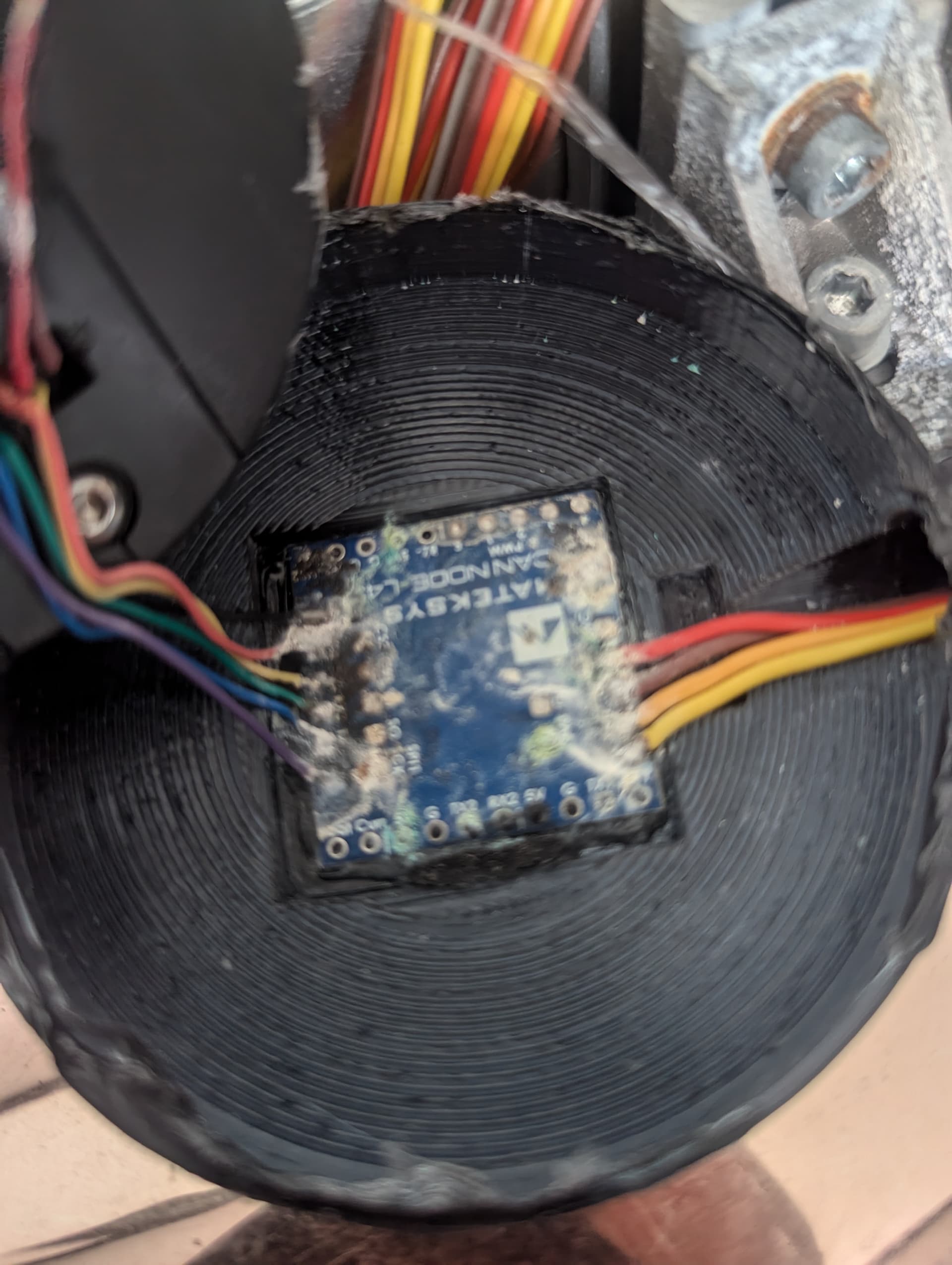

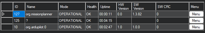

I have ran into an issue with canbus acting weird. its showing devices on it but the GPS is saying no fix and the led isnt coming on. I think it could be related to this missing resistor. I dont have any 120ohm resistors so I ordered some.
it takes a really long time for its name to show

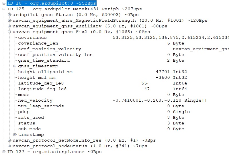

its getting a fix there just isn’t any data coming through.
I got the PWM output working, I think the issue was I had some outputs set to gpio, they were set because I restored a backup, once I disabled all the outputs I wasn’t using the PWM started functioning.

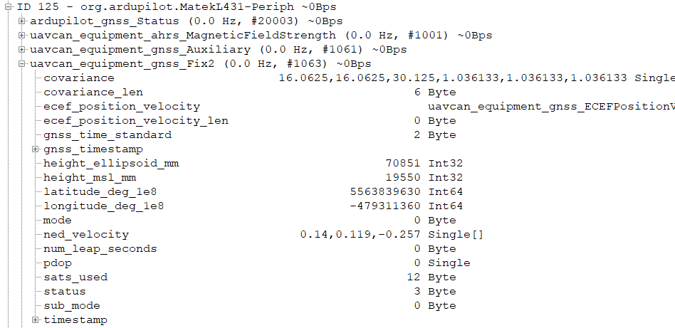

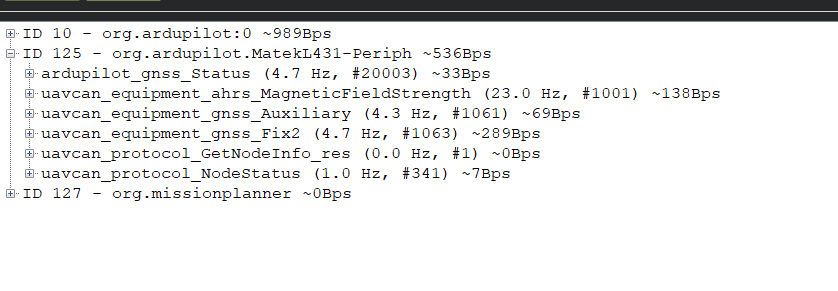

CANBUS GPS is working !!!
I tried enabling NTRIP just to see what would happen and it immediately changed to 3d fix !
ok this is really weird, if i stop ntrip the gps stops sending data.. other than this one little issue everything is now working.
ok setting CAN_D1_UC_OPTION to ClearDNADatabase fixed the GPS problems, its all working apart from the led on the GPS.

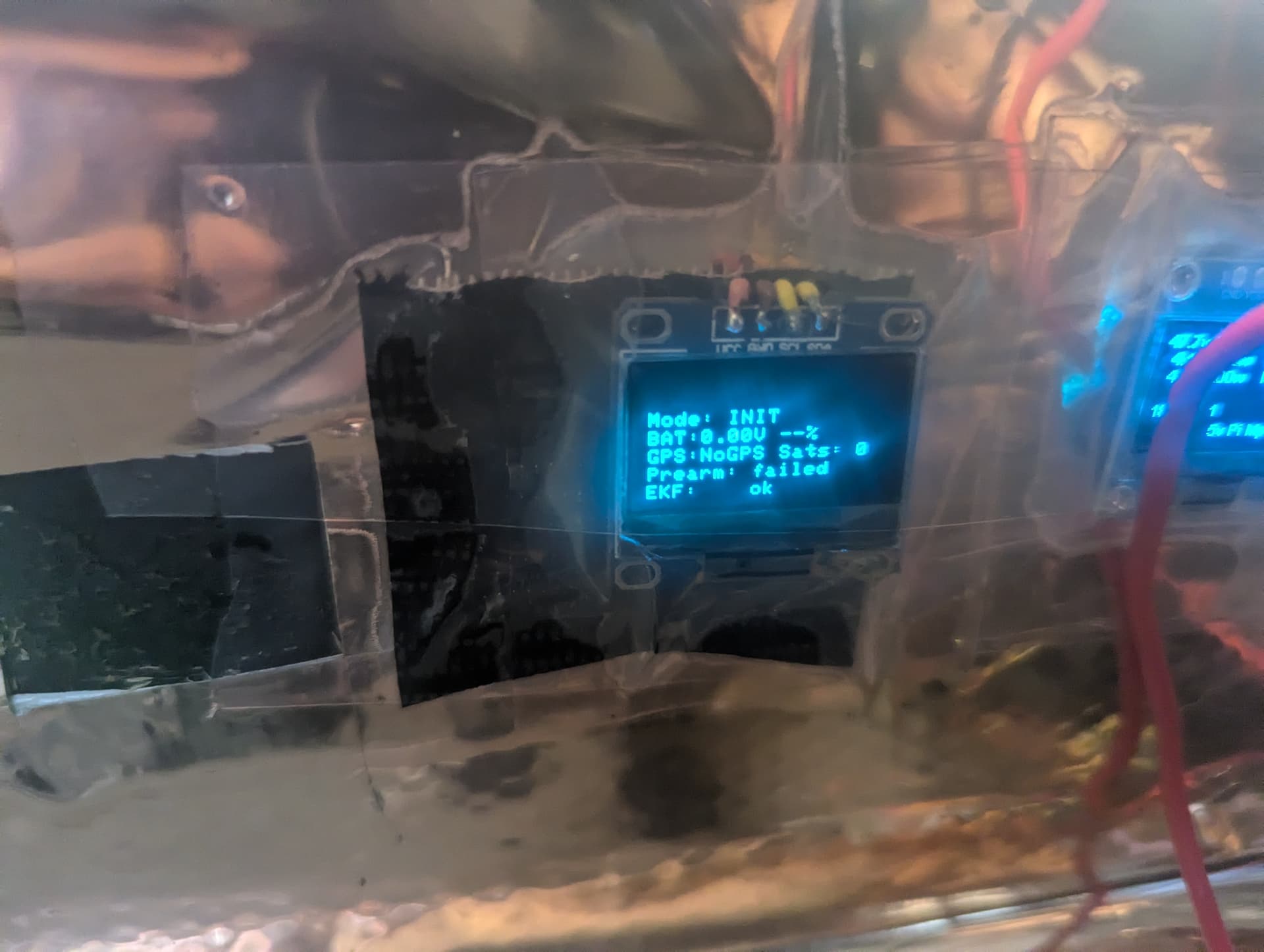

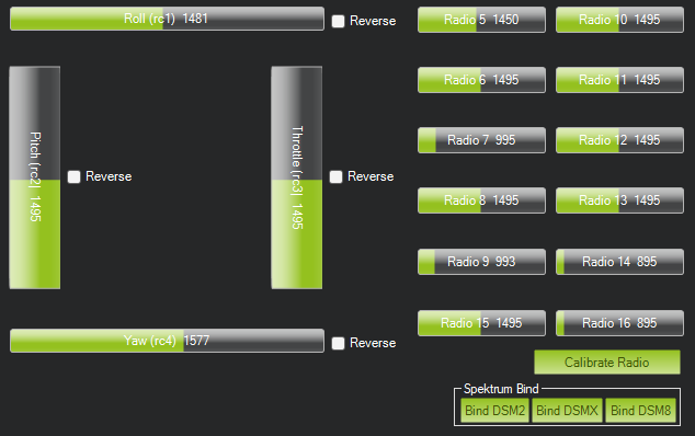

I have also discovered that the SBUS input is sketchy AF, if its not connected to anything it just detects random values on every channel. it was arming and disarming on its own.
Relay output is working on the GP0 connector with, I tried setting them to buttons but it wouldn’t start up when i did that.
GPIO1_25 = pin 57
GPIO1_17 = pin 49
GPIO3_20 = pin 116
GPIO3_17 = pin 113
Ok I suspect I found the issue with my CAN GPS…
I’m actually surprised it worked at all, rather than spend more time getting canbus working at the moment i have just disconnected the RC telemetry and connected the GPS over Serial, I have a second controller and GPS I will continue to look at but for now this is working good enough for me.
