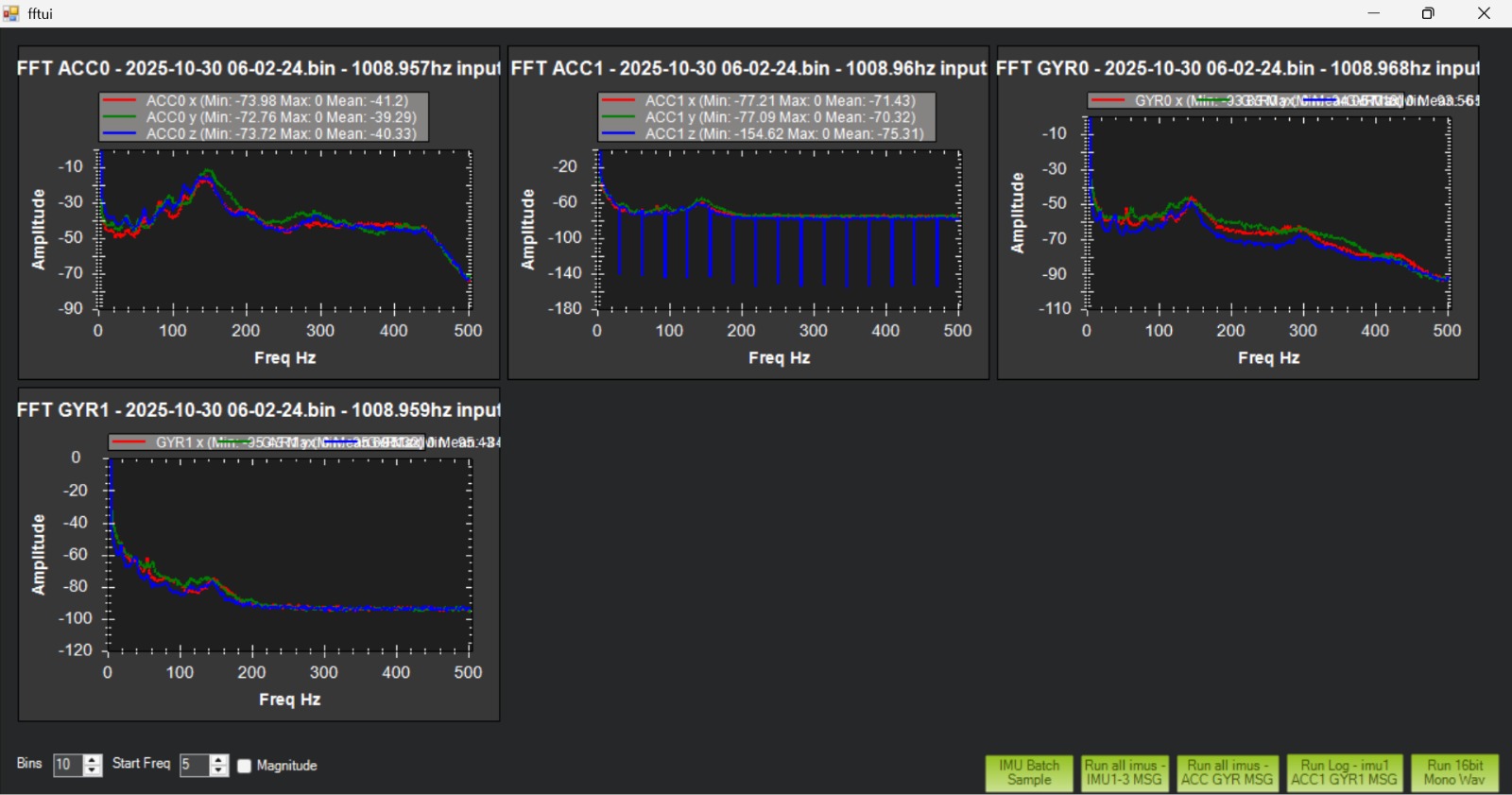

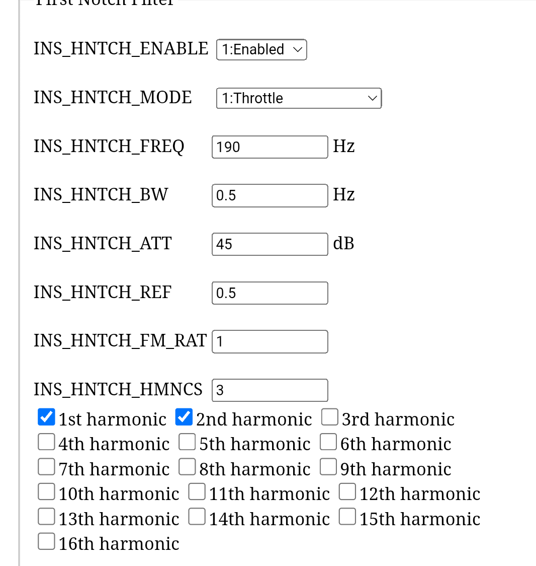

7 inch iflight chimera7 pro v2 up down fast oscillation on 140 kmh
I currently in tuning phase of 7 inch Quad flying mostly on position hold mode all tuning process goes will a lot of issues fixed the only issue currently I face is a very high vertical oscillation once reach speed of 140 kmh the esc has no rpm telemetry I use throttle based notch filtering, motor used kv 1350 on 6s 5500 battery.
