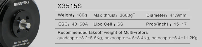

His current configuration is 1.2. Which apparently is the lower limit according to this. Even if it’s just for take off / landing, I wouldn’t trust the motors to deliver exactly what the manufacturer claims and get a setup that leaves some safety buffer.

I want to make sure you saw this info on the Sunnysky website.

Oh, thats true, I was looking at another engine specs… 5.6kg is definetely not enough… But still worth to try with different ESC and no payload just to make sure that it was ESC problem, as even if its not enough thrust it should not make this weird sound.

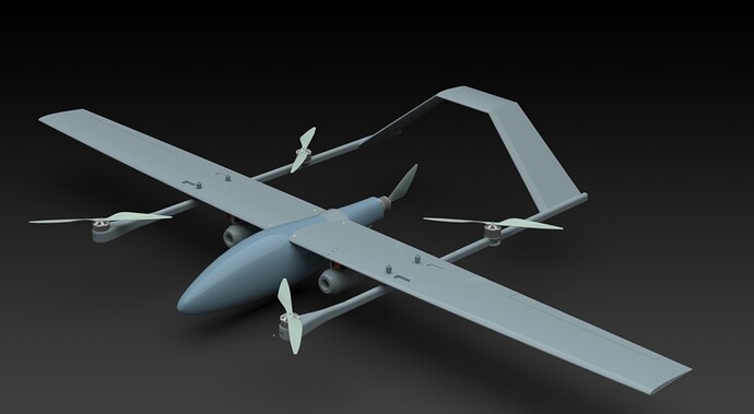

Will switch escs soon, for now will update the design a bit as indeed tail of the plain is way to heavy and basically useless. This design is better
Looks very nice. I been designing a few VTOLs in plastic and understand just how controlling weight is important. Currently I have a 5 .5 lbs bird with a 1.2 wing. I also have a 4.2 lbs design 1,2 m.
What was the thickness of wing/fuselage skin(*?) ? I am using 1mm, was trying .8mm and it works fine, but very easy to break if press locally
I have a odd infill design i came up with a few years ago. I model a air gap between the outside and inside walls, That gap is adjustable so I use 1.7 mm to 3 mm. No warping in the sun unless your outside for days and overall somewhat strong.
