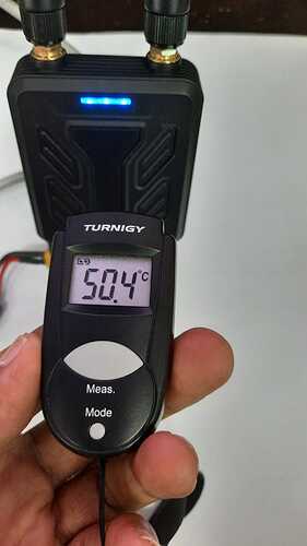

One thing that is still a concern is the temperature of the Ground unit. Is 50 Degree Celcius measured at the heat sink common to everyone here?
thanks
I haven’t measured mine, but it gets quite hot for sure.
