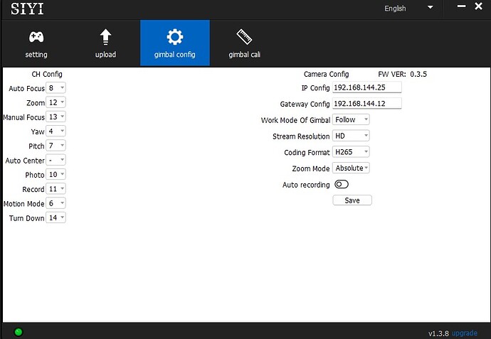

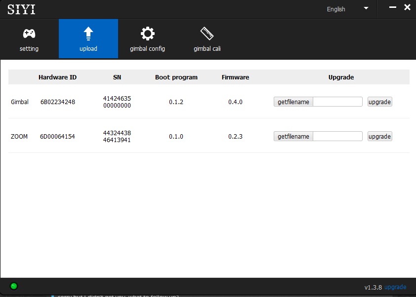

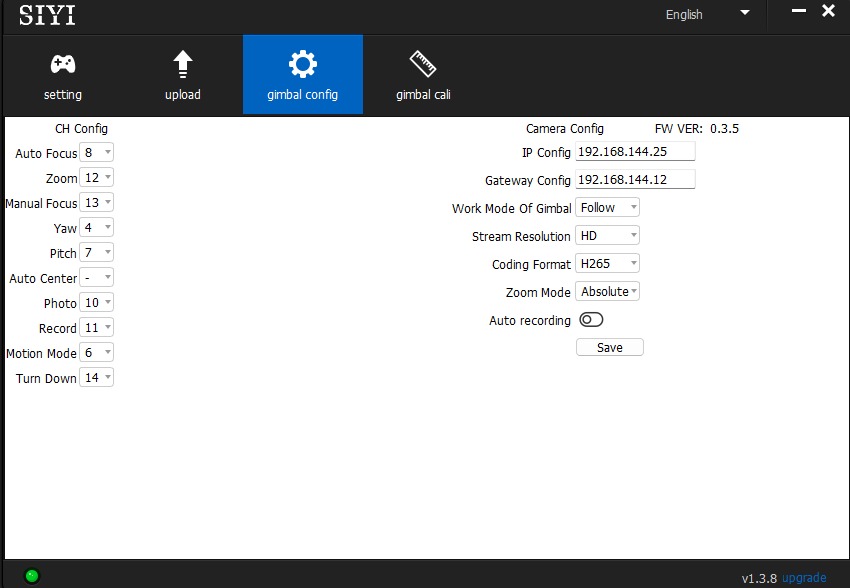

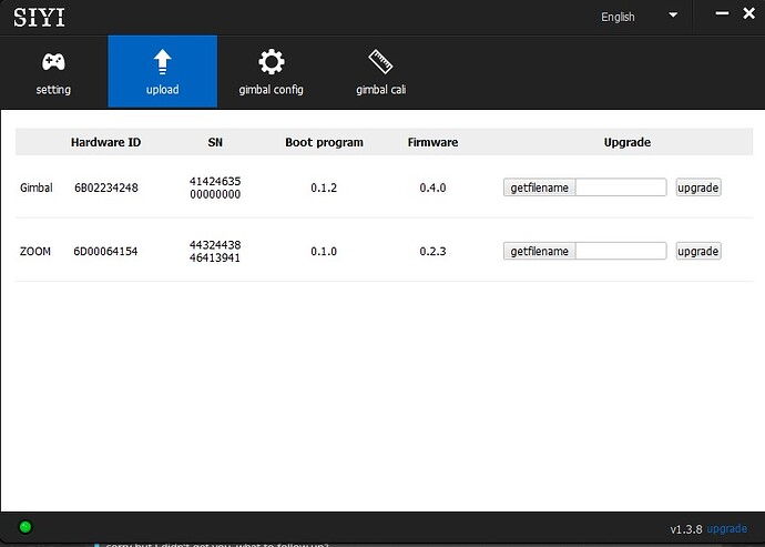

Hi @SIYI .
Thanks for the response. We are using SIYI PC ASSISTANT v.1.4.5, with camera version 0.3.5, gimbal version 0.4.0 and zoom version 0.2.3 with the ZR10, with GCS Mission Planner 1.3.82 (ArduPlane 4.5.7.)
Battery voltage is good. This has been tried across different batteries. It was not an issue before updating the gimbal. A video is attached of the issue via google drive, which can be resolved by shutting off the flight controller. It stabilises perfectly fine on its own.
It is connected to a HM30 air and ground unit. Both are updated to latest versions (v0.1.9, v5.2.8.)
Hope to hear back soon. Our flight controller’s AHRS is level and steady, and configured properly, so I do not know what to do.
Thanks very much.
