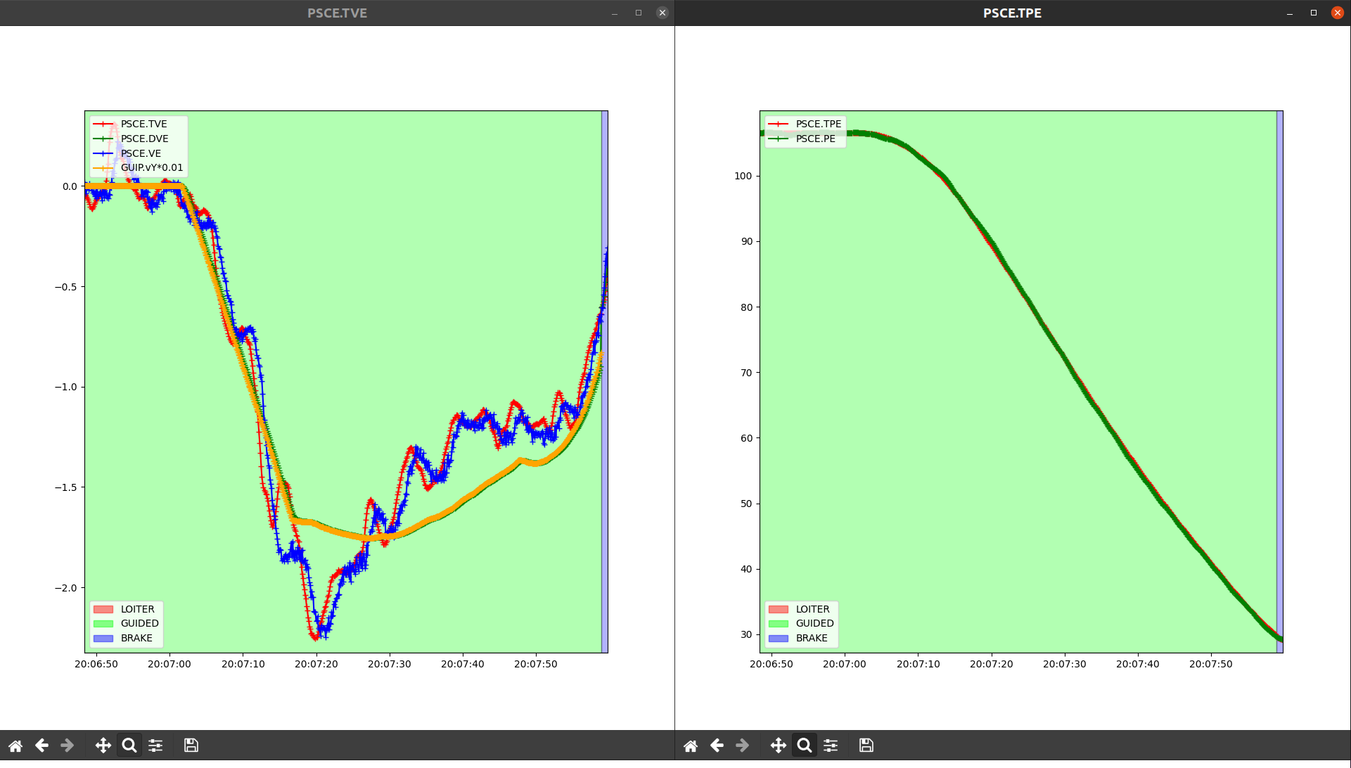

However, I’m still experiencing some issues with poor tracking. I’ve noticed that when velocity tracking degrades, there’s a significant difference between PSCE.TPE and PSCE.PE as you see in the screenshots. The same applies to the vertical component.

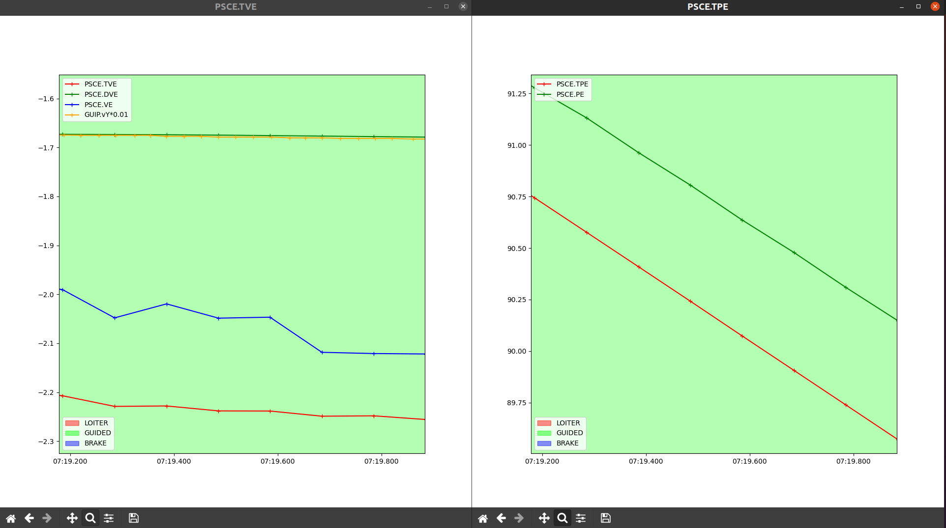

If the above image is zoomed in around timestamp 20:07:20, we get:
The difference of 0.5m in PSCE.TPE and PSCE.PE shows up as difference in PSCE.DVE and PSCE.TVE of 0.5 m/s.
Do you have any suggestions on how I could compensate for this and improve the velocity tracking?
Hi @teju,
This doesn’t look like an estimation problem, instead it looks like a tuning problem. Your aircraft will be limited by it’s basic manuverability properties and your controller tune.
It looks like you are getting something that looks like an occilation in velocity but given your target and measured velocity look like they are tracking reasonably well this may be just your position P term that is a little too high.
You may be able to get better performance if you did a full tune starting with the vertical acceleration controller. This is rarly required for most multirotor aircraft so support and guidance on how to best do this is hard to find.
