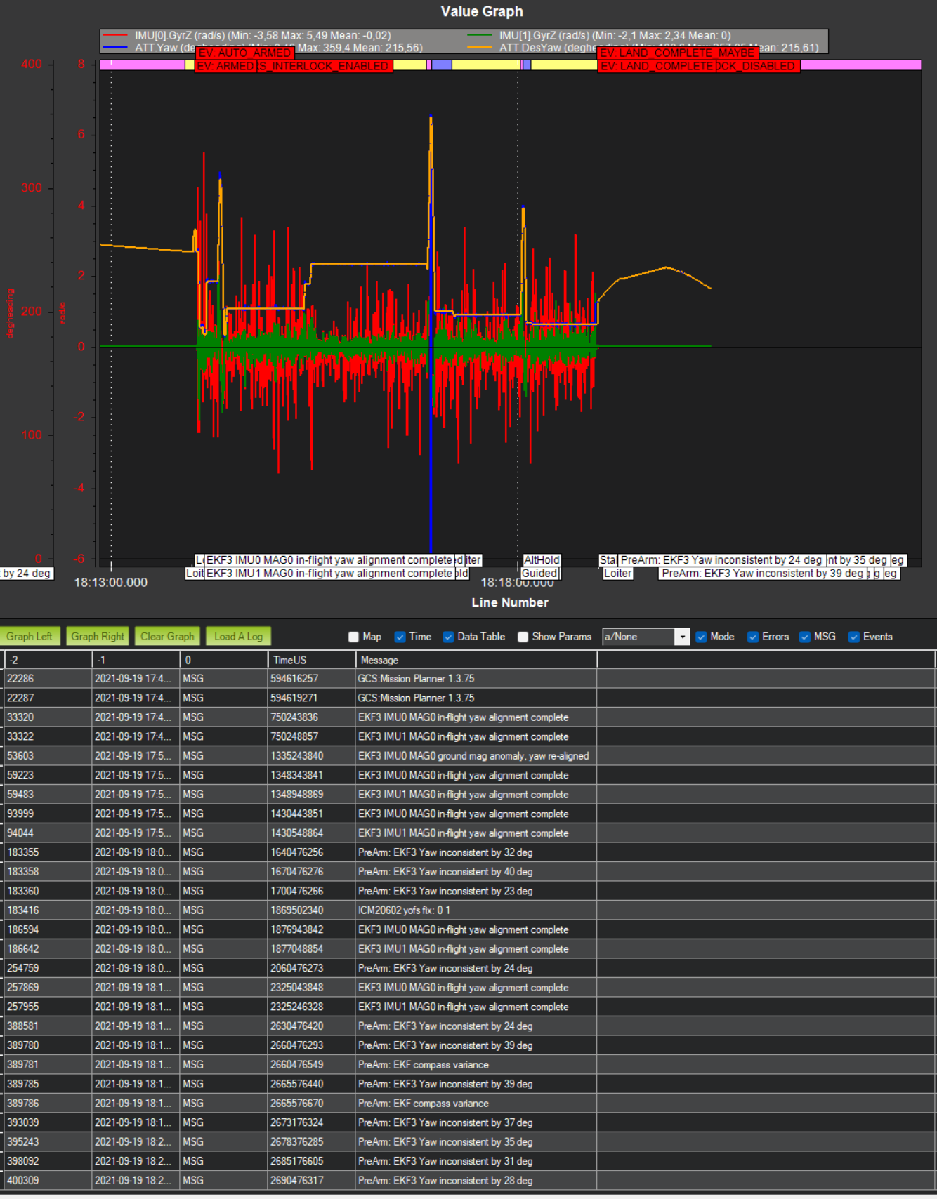

Here is yet another test with problems:
I notice lots of “EKF3 IMUn in-flight yaw alignments” and “yaw inconsistencies by X degrees”:
Do such alignments are connected to the compass, or could they be connected to the IMU discrepancies?
Another question: Do you know if both IMUs are in the same SMD?
ps: Does the EKF uses the both IMU at same time?
I typically see those as Compass problems. I have a small quad with an H743-mini and I occasionally see those messages and assume they are compass problems. It’s tight quarters on that craft and I use a Li-ion battery.
They are separate devices.
I believe the data is fused from both IMU’s but not absolutely sure about that.
