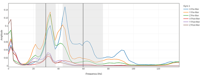

Hello all, I am facing issue with yaw without any commands. I have a quadcopter with tmotor 230kv motor , 40amps hobbywing esc, 24inch foldable prop, 33600mah battery connected in parallel and Cuav x7+ FC. The copter is yawing while takeoff and landing without any commands. As I did accel and compass calibration many times but still the issue is not getting solved. I did autotuned the drone for 3 times still issue is not yet resolved. I am attaching a log below please have a look and suggest me what best can be done.’

Motor outputs are very different indicating a physical yaw bias. You can see motors 1 and 2 are even hitting minimum. This will be making attitude control very poor compared to what it could be.
Look for twisted motor mounts or frame.
It also means there’s a lot of extra noise peaks to deal with:
Are you really certain you motors wont spin at lower settings than these?
