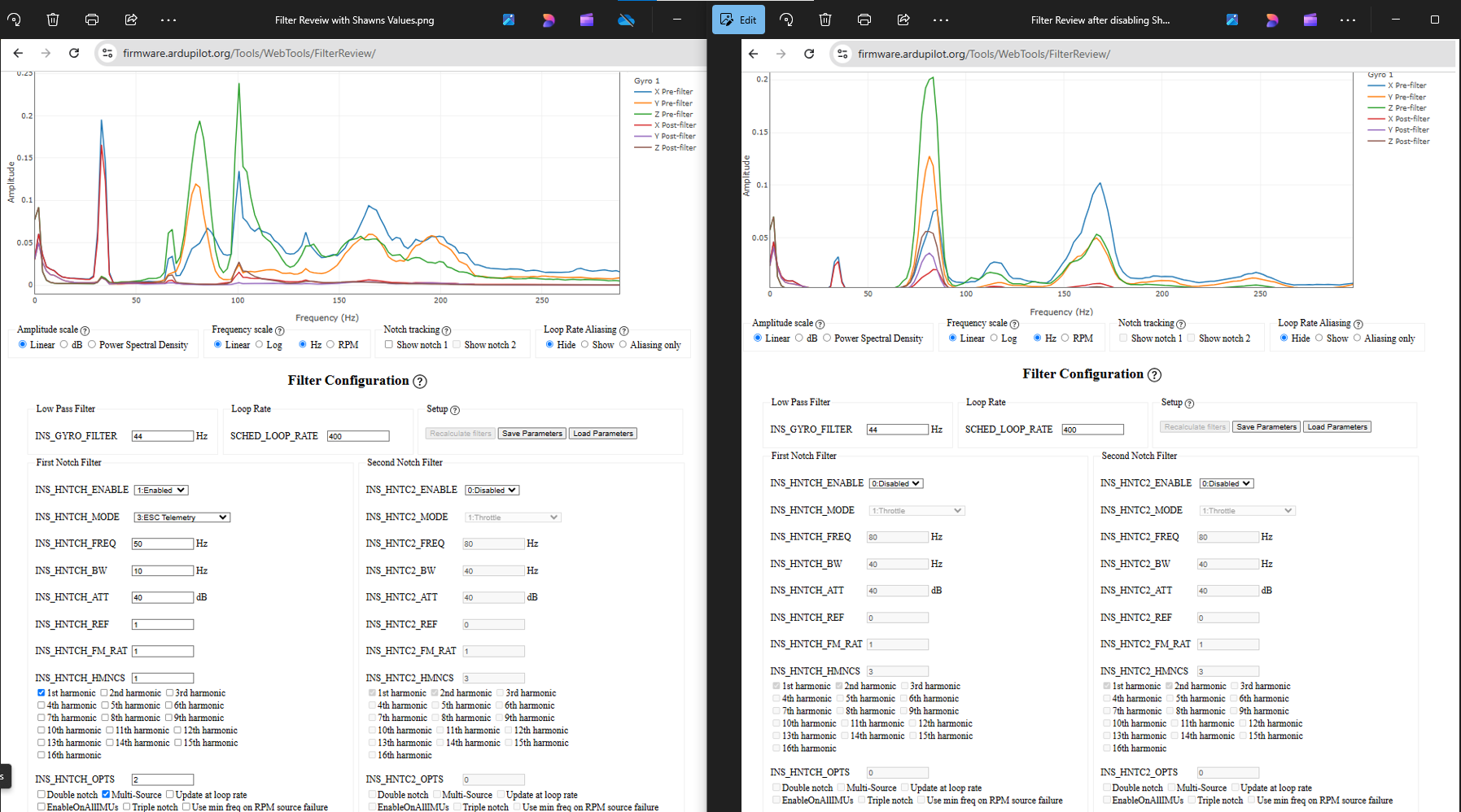

I’ve put your selections into the Filter Review utility to make sure I’m doing it correctly.
For some reason the “grey” area around the notch filter in my example is much more narrow than yours. Is there something else I should select?
Here’s my Before and After:
BEFORE the Filter Review Tool estimate:
And AFTER the Filter Review Tool estimate:
I’ll do another test flight and report after I can get this to match yours. Thanks!

Checking that flight in the Filter Review tool - the notch filter has these results:
In an earlier comment from @xfacta he recommends setting INS_HNTCH_FREQ=50 and INS_HNTCH_BW=10. When I plug these values into the Filter Review tool, the estimated values for X, Y and Z axis amplitudes are all slightly higher than what my present values are from my last test flight.

I used the Filter Review tool to compare my post filter results using BW of 40hz with your suggestion of 15hz. Here’s what the filter tool reports for the comparison:

Yea, looking good. It’s helps to show the tracking bands. I suppose I would try these and make another flight and see how it actually works. Not much different than what you have:
