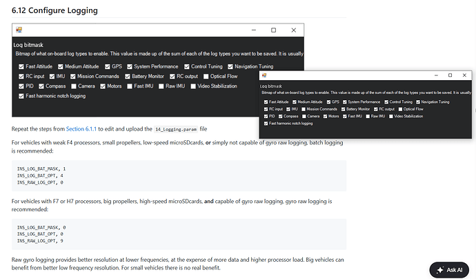

My settings for log_bitmask includes the “Fast IMU” bit.
Good point, I need to update that outdated screenshot, Peter Hall told me specifically to not activate that bit. I have updated the software, but not the screenshot. Thanks for the heads up.
@iampete - could you please share about using the “Fast IMU” bit in the LOG_BITMASK parameter?
I’m going through Chris Rosser’s youtube tutorial on Ardupilot copter tuning - and he doesn’t mention excluding it. I’ll suggest he correct this if it’s a problem.
Thanks!
I don’t have any strong opinions on “Fast IMU”, just leave it at default.
The key thing is not to check “Raw IMU” and rather use the new " INS_RAW_LOG_OPT".
