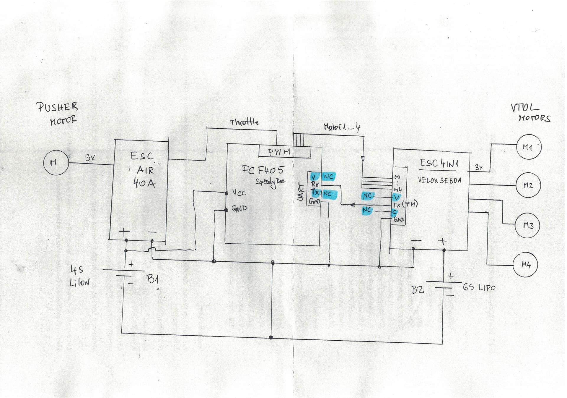

I am right now wiring my printed Cobra VTOL in dual battery setup. Meaning: one LIPO battery (3.3 Ah) for the hover motors and another LiIon battery (4S4P 14Ah) for the forward pusher motor.
My setup is:
FC: Speedybee F405 Wing,
ESC Hover: TMotor Velox V50A SE 4IN1 (BLHELI 32)
ESC Pusher: TMotor AIR 40A
Hover Motors: 4x Velox V3115 KV 640
Pusher: TMotor MN4010 KV 580
The intended wiring diagram is as follows:
Here are my questions:
  • I want to monitor both batteries, voltage and current, in the OSD separately. Bat1 is clear, we get it from FC as usual. For Bat2 I am planning to use the Telemetry port which is available in the ESC. For this it shall be connected to the UART Rx Port. Which telemetry protocoll can be used here ? And can I use than this data (Voltage2, Ampere2 and used capacity2) in the OSD ?
  • The Voltage connectors of the ports I leave not connected because ESC 4in1 and FC are in different potentials.
Thanks !

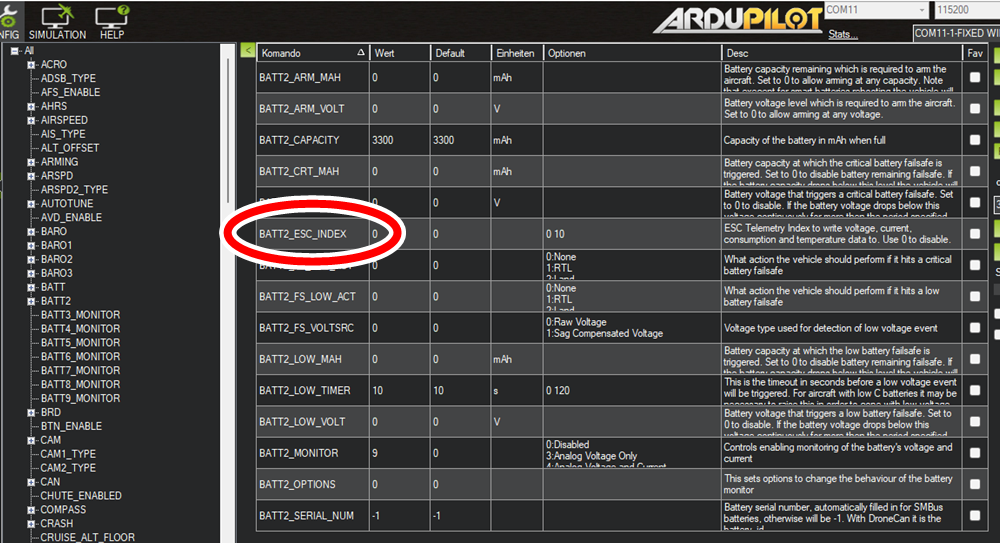

You can set BATT2_MONITOR to 9 (ESC) and use BATT2_ESC_INDEX to select the ESC whose telemetry data is to be used as BATT2.
Rolf

Unfortunately BATT2_ESC_INDEX not included in the official firmware. Obviously a custom production is needed to include this
you will surely find the parameter in 4.5.7 stable

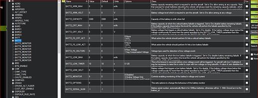

This is from Mission Planer and from the FC.
Why this parameter doesnt appear ?

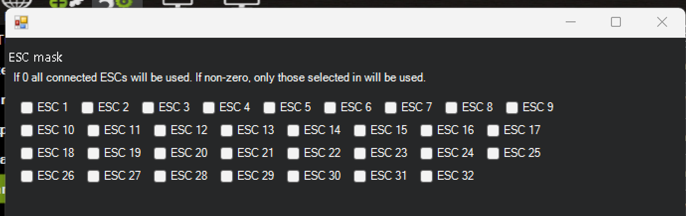

Yes, in the current beta there is a better mask BATTx_ESC_MASK

But you are right, BATT_ESC_INDEX is not in the current stable firmware. It is possible that all ESCs are evaluated. BATT_ESC_MASK is only available in the beta.

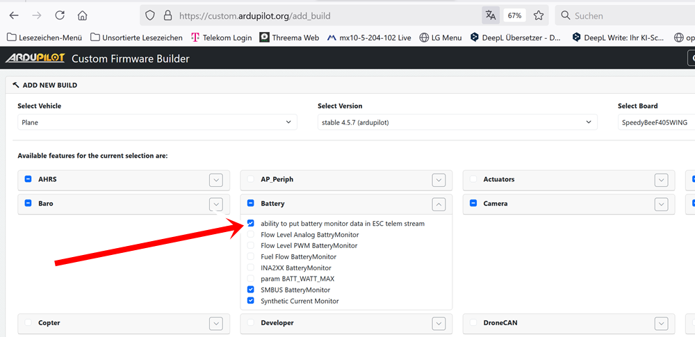

A clear advantage for those who can read. Sorry, I had completely overlooked that BATT_ESC_INDEX feature is usually only available as a build option using the Custom Firmware Build Server
Rolf
