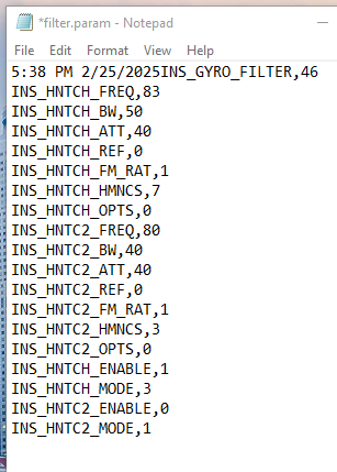

I set the peak of the first hump of the curve and approximated the bandwidth and had the utility calculate my notch filter values. I set the frequency to 83 and bandwidth to 50. I then did the re-calculate function, and saved the new parameters - and loaded them onto the copter.

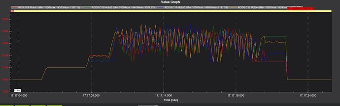

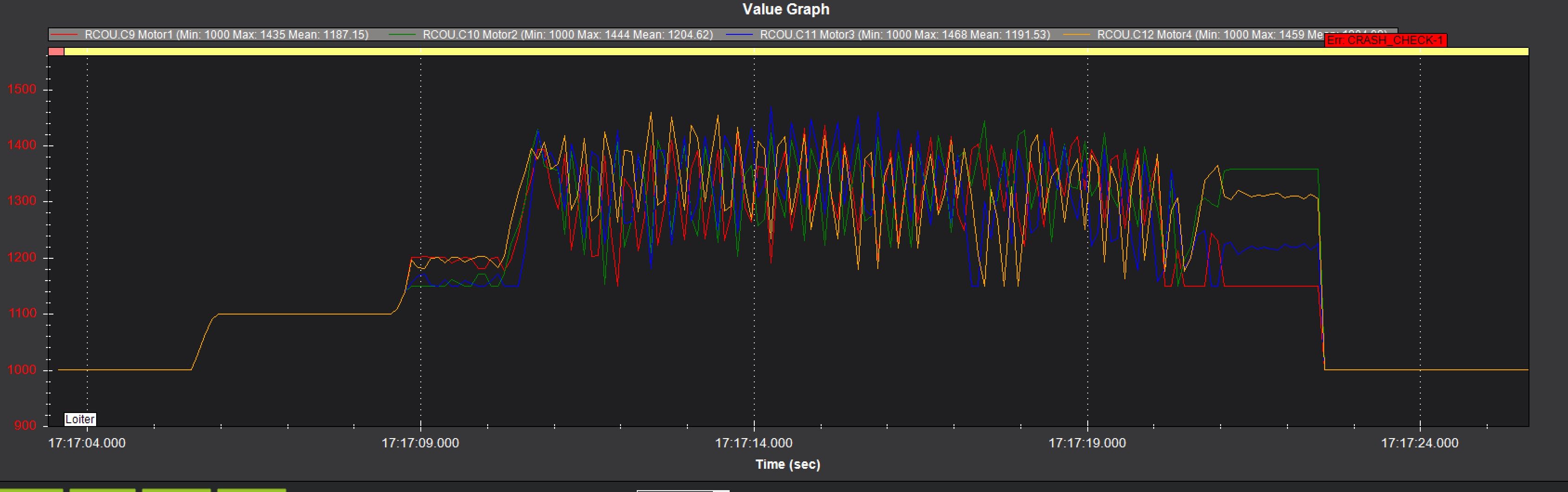

If this is the same craft you posted about a couple days ago it still has outputs oscillation on default Rate PID’s. And the Notch filter is doing nothing as you have the reference at 0. Or maybe it’s doing something but nothing good…
Here is the evidence which you can easily reproduce to do some basic tuning before configuring the notch filter.

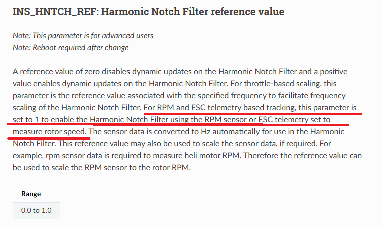

I think you may have spotted my mistake - I had not changed INS_HNTCH_REF to “1” for ESC rpm telemetry. For the benefit of others:
I’ve set up ESC/RPM notch filters before - and used the IMU Filter Review Tool - but for some reason I don’t recall this parameter - and didn’t have this problem.
