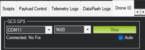

The problem is that the Drone ID tab on Mission Planner requires a serial connection to a USB device. The GPS-RTK Base station is already serially connected to RTK injection in Mission Planner. They cannot both connect to the same COM port.
DroneIDTab

The Drone ID requires a GPS fix before the drone can arm. I can connect a separate GPS receiver to the USB port and connect that GPS to the Drone ID tab. The GPS will get a fix, the drone can arm, and the system will work correctly.
The Drone ID and GPS-RTK cannot simultaneously connect to the same COM port. I wanted to use the GPS-RTK receiver for both the GPS-RTK injection AND the Drone ID position fix. It does not appear to be possible to use one receiver for both purposes. The other poster claims that the GPS-RTK does not output the location information in the format needed for the Drone ID tab in any case.

The external GPS is needed because I have enabled Drone ID. Mission planner will not allow the drone to arm unless the GCS has a GPS fix if Drone ID is enabled. If other users want to use Drone ID, I think they will need a GPS module connected to their laptop.
This is what is looks like to connect the GPS to Drone ID in mission planner:
DroneIDTab
