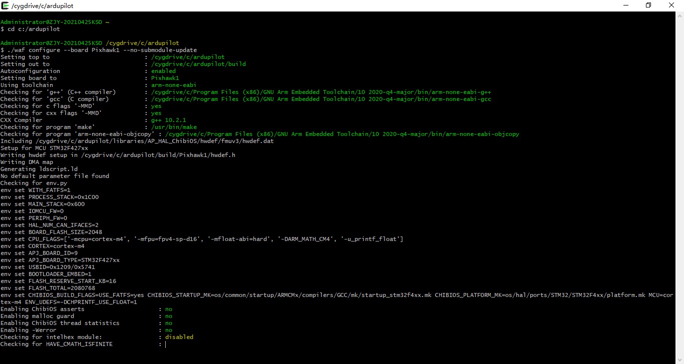

Using eclipse compile errors occur
Do as these page https://ardupilot.org/dev/docs/building-setup-windows-eclipse.html#building-setup-windows-eclipse.Import and use cygwin to complie and build ardupilot, errors occured,about “g++ tool not found”
.however,Use cygwin terminal alone to complie and build ardupilot project success.how to solve it?

Already done,I think if I did not install script and gcc compiler,build in cygwin terminal would fail.And I configured the system path,but eclipse console show errors.
Would you please post a screenshot of the errors you get in eclipse?

Here are the two screenshots,cygwin ok,eclipse failed…
I wonder if your path variable for GCC is set in Eclipse? Clearly it is for cygwin itself though…

See below in my eclipse.
In the PATH variable I find C:\Program Files (x86)\GNU Arm Embedded Toolchain\10 2020-q4-major\bin;

Hurrah!I solved it as your instrcution!You’re wonderful,Josh~ :+1: :+1: :+1:.I think I just did some wrong configuration about build path as the picture shown below: added the path variables in the “C/C++ Build”----“build location”:rofl:

Just so that I can update the documentation, you changed C/C++ Build -> Environment -> PATH -> and added C:\Program Files (x86)\GNU Arm Embedded Toolchain\10 2020-q4-major\bin; ?
yeah,and by the way,do not add “waf” in “Build command” shown picture below,and it should be configure in the project build item lonely
You can put “waf” in the build command if you want as long as you dont then also include it in the build target commands. However, I’m sure there are many ways you can setup compilation so whatever works :slight_smile:
