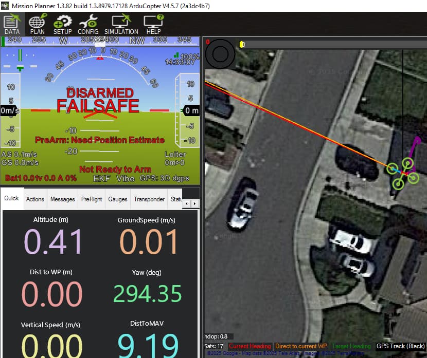

I am running into this issue as well.
By default you can arm in non GPS modes without good GPS fix. Geofence requires good position estimate or it won’t let you arm in non GPS modes without GPS lock so you won’t be surprised by Guided or Loiter being denied in flight.
I disabled Geofence but still same issue “need position estimate”. This is my 7th quadcopter build and I have never encounter this issue before on any of my quadcopters.
The GPS lock is solid, 20 satellites, HDOP at 0.8.

You can see in the image on the bottom that I have good HDOP and # of satellites

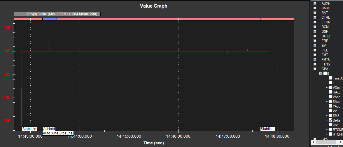

That is not what I said. I did not said to change the RATE parameter. I said to check in the .bin log to see if the desired GPS update rate is getting achieved.
Great HDOP and 50 satellites at 3Hz will still produce bad GPS health.
HDOP and number of satellites are irrelevant if the update rate >= 5Hz is not achieved.
Is this what you are asking? If not, point me to the correct attribute to check.
No……………………
GPA>Delta
5Hz, where it should be.
That looks good, only a single spike below 200ms. So the update rate is not to blame.
