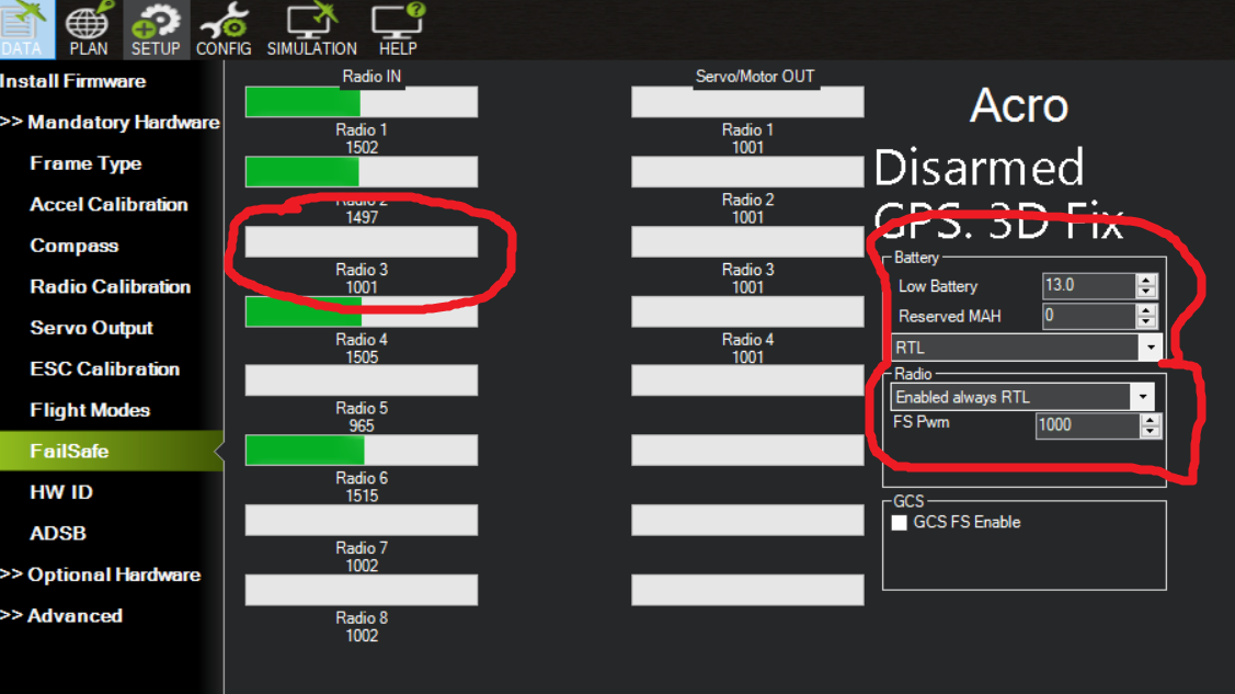

OK, I am completely lost. I am seeing a “FAILSAFE” error on the HUD and in the Messages tab in Mission Planner, but I am failing to see why. I have set the FS PWM to 1000 (or lower), and the RC radio is emitting throttle signals above 1000 (it’s actually 1001 at lowest throttle). Why is the copter in failsafe mode??
I am using Futaba T8J + R2008SB (SBUS).
And the HUD…
Any thoughts of what might be happening? Why the failsafe??
Your failsafe value is too high. Turn it down to 975 and see if that makes the problem go away. Some times if the TH_failsafe is too close to the min throttle value you’ll get these false alarms.
Unfortunately that doesn’t make a difference. I set FS_PWM to 975, 965, etc, and the HUD still reports “FAILSAFE”.
When you’re on the failsafe page does the throttle input move with the stick?

Yes, as I move the sticks, I can see the output real time on the green bars on the left. They vary between (roughly) 1000 and (roughly) 2000.
What do you mean by “what does it set up for failsafe?”. I can set the failsafe behavior in the TX to whatever I want. Currently it’s set to send “0%”, which I believe corresponds to 915us. I tried various values between 915 and 1000, and I still see “FAILSAFE” by default on the HUD even when the throttle is always above 1000.
This seems to be a problem with 4.1-dev and 4.1.0-beta. I switched back to 4.0.7-stable and the “FAILSAFE” condition on startup went away, as one would expect. However I am seeing other issues with 4.0.7 (“gyros not healthy” errors) – I will start a new thread on those.
