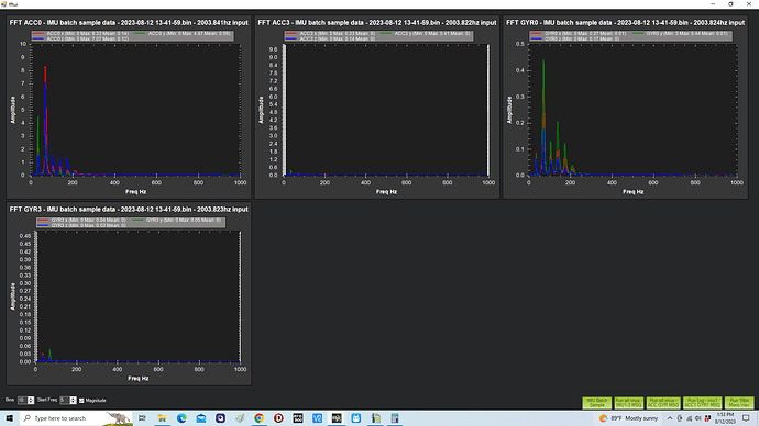

I’m working through the tune steps on a new Tarot X4 with 22" props.
I’m working through slowly and carefully through the wiki - there have been lots of really good updates. Thanks to whomever has made these improvements to the wiki!
I’ve just turned on the IMU batch sample options - to view the vibration status - and identify the peak frequency.
As I understand the charts - it appears as though the low-pass filters are already providing massive attenuation to the vibration. In fact, I’m now wondering if setting up a notch filter is needed at all.
I’d really appreciate if someone would take a look at what the data is showing - and help me understand it a bit better - so I can move on to setting up an appropriate RPM notch filter.

I would say it is definitely worth it.
You are correct that the standard INS_GYRO_FILTER does knock out quite some noise. But less is more in this case :slight_smile:
You have ESC RPM data available so that will make it easy.
BUT the trouble is Ardupilot is logging RPM at about 4500, where as the noise is around 2100 RPM.
So I would say you have the SERVO_BLH_POLES wrong for your motors.

Once you plug in the correct number of poles (count the magnets in your motor) then you can set these:
INS_HNTCH_ENABLE,1  // write then refresh params to see the rest
INS_HNTCH_BW,10
INS_HNTCH_FM_RAT,1
INS_HNTCH_FREQ,30
INS_HNTCH_HMNCS,3
INS_HNTCH_MODE,3
INS_HNTCH_OPTS,2  // per-motor notches
INS_HNTCH_REF,1
And this should cover you for any eventuality, including different payloads, or a changed COG.

X axis vibrations!
Not disastrous but less than ideal.
Needs a bit of work and is likely causing all those peaks on the noise graphs.
Probably something like flight controller wiring pulled tight one way, or very uneven vibration damping.
Maybe prop balance…

The spec sheet for these motors say that this motor has 14 pole pairs. So I have the “poles” parameter set at 14. Maybe it should be 28 for individual poles.
The sanity check is what rpm would one expect for 22" props. I’m showing 4000 rpm in hover. If I set the “poles” parameter to 28, I’m guessing it would show 2000 rpm in hover.
And as the default parameter value for “poles” is 14 - I just went with that.
Counting the number of magnets on these motors is possible - but not exactly easy.
I’m thinking I’ll just change the number of “poles” to 28 and re-fly the initial test flight and look at the charts again.

If you set 28 then you can also set all the params I recommended.
I recently noticed the same RPM/Hz discrepancy with one of my copters. There are two versions of the motor and I had the poles wrong.
Exactly what motors are they?
I suspect you will have 24 pole motors - that would be typical.
They are Mad-Components 5010eee V2.0 240KV motors:
The spec sheet says they have 14 pole pairs.
Interesting - I don’t find it in the web page for the motor - but the recap on my thread post mentions that the motor is a 24N28P. Odd that I can’t find that on the web page for the motor. But I guess that settles the question about the number of poles.
I dont know why some manufactures have to try and be different and say something so ambiguous as “14 pole pairs”
I think it will be 28, but you could try 24 if that’s not quite right.
Just send a log of a tiny test flight with either and we will know for sure.

For those following 28 poles was confirmed correct - frequency and RPM match in logged data.
New information to hand - when using INS_HNTCH_OPTS,2 for per-motor notches use INS_HNTCH_FREQ / 4 for the bandwidth to avoid too much phase lag.
So for INS_HNTCH_FREQ,30 you should use about INS_HNTCH_BW,7
Or just keep these values for NO per-motor notch, which is probably perfectly fine with copters that aren’t doing high lean angles all the time.
