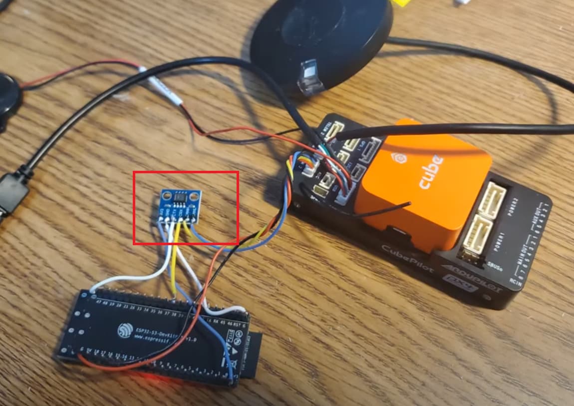

Hi , I am stuck at bootloader update process. I want to follow your solution given on Cubepilot.org. the difference is my board is CubeOrange Plus STM32h757 and Ardupilot - 4.5.7. I have got St-Link V2 and ESP32S3 DevicekitC-1 also. How can I use this to solve my problem.
I read your solution for bootloader update on Cubepilot.org(How to activate DFU mode on cube orange plus.)
I am sending the link of your solution.
How to activate DFU Mode on Cube Orange+ - #4 by sidbh - Cube Autopilot - Cubepilot
Please guide me for that.
Should I use the deviece marked in red Rectangle to connect Cube orange plus with ESP32s3?

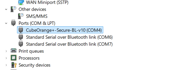

I have already tried this but can not connect to CubeorangePlus because in device manager,the device displays as CubeOrange±Secure-BL-v10 not as Mavlink COM so unable to establish conectivity with the board. Please check the image I am attaching here.
