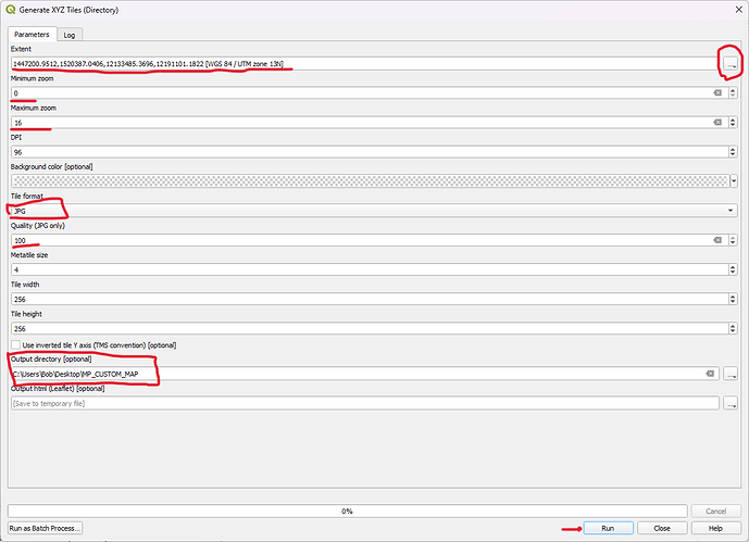

  1. Start with a map in QGIS that you want to export (making the map is beyond the scope of this tutorial). I am simply using a georeferenced pdf that I imported into QGIS.
  2. In the Processing Toolbox, search for “XYZ” and select “Generate XYZ tiles (Directory)”
    Screenshot 2023-09-30 074832
  3. Configure the output options
    a. Set the extent. Use the button on the right to calculate the extent from a layer, or select Draw on Canvas to create an extent manually
    b. Set minimum zoom to 0
    c. Set maximum zoom to something like 13-16. This depends how detailed your map is, since the exported map can’t be any more detailed than that anyway. Setting this too high can cause the export to take a long time. Each extra zoom level takes 4x as long as the previous zoom level to generate. Experiment with this setting.
    d. Set tile format to JPG
    e. Quality 100
    f. Output directory. Put this wherever you like. I chose Desktop. You will delete it later.
    g. Click Run
  4. Wait for the run to complete
  5. Place the above script in the folder above where you exported your tiles.
  6. Drag the exported folder onto the batch script
    Screenshot (1)
  7. Wait for the script to complete. Your map is now installed in Mission Planner.
