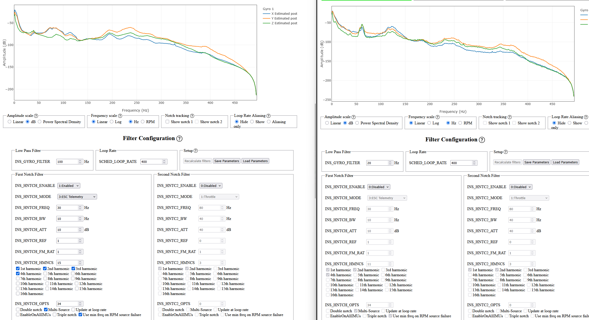

I build a 3d printed frame 22 inch quadcopter 5kg empty, 14kg auw and like to ask for tuning advice.

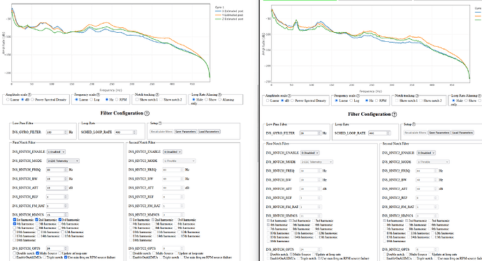

I don’t have a lot of vibrations so generally just INS_GYRO_FILTER set to 20hz is enough to keep the vibrations lower than -50db, but If I use RPM notch filter I can set INS_GYRO_FILTER to 100hz and have also same -50db noise.
Which way is preferred?
Any tuning advice are also welcome, Is current setup OK for autotune? Or should I try to tune PIDs manually?
bins are here
What’s preferred is to use either Batch Logging or Raw logging, not both.
And, if you use batch logging set the option to 4 not 5.
