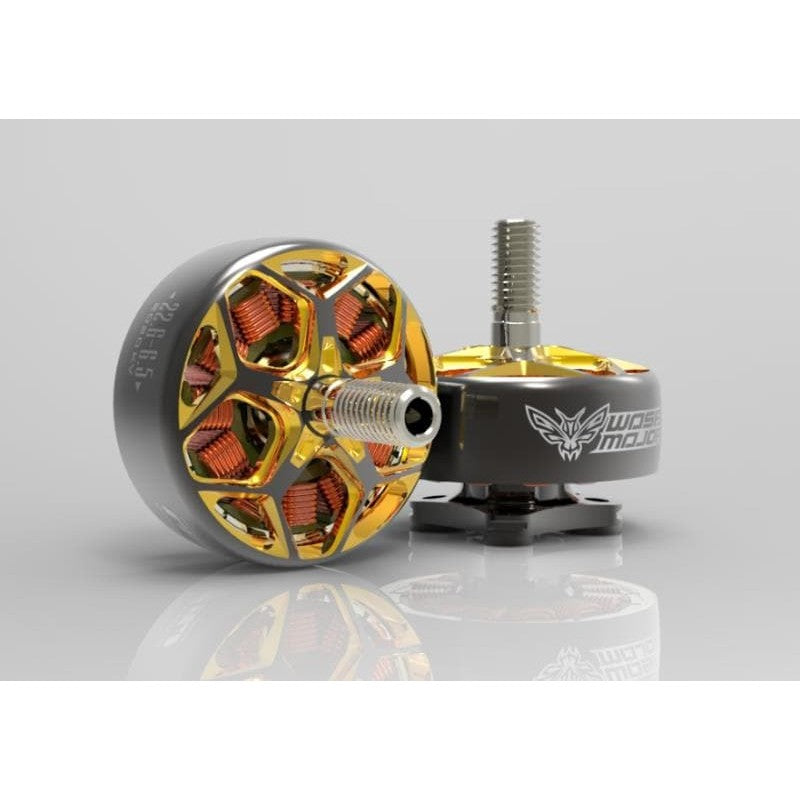

i dont know much about the different dshot protocols, i am making a fairly heavy drone for research purposes, the most important things are small size and flight time, but still needs to be able to lift a load.
i am running 4 inch props on RCINPOWER WASP MAJOR 22.6-6.5 motors
Use Dshot600
ok i will switch and see how it goes
