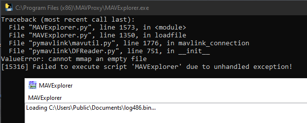

That’s funny:
Not me nor my computer nor my path nor my board ???
That is a path on the developer computer
I know I’m dev as well.

The point is it’s 500 short logs… I wrote a script to combine them but they are not sorted in it finally.
Have no idea why log numbers are not growing with time.
On your picture above all logfiles show 01.01.1980, Only last shows 01.01.1970
All this happens so far I have seen if your FC has no valid time information. It seems that your FC had multiple resets.

it seems it’s overloaded by download loosing SD connection:
Did you tried to disable logging and afterwards to download some files?
Combined log entries indicate significant gaps in timeline, potentially due to MCU lock or SD card transmission failure.
I replaced the SD card with one that I know is good. It looks better now, as I have one large log file.

Better for others to follow is to show your combined logfile instead of just a screen shot.
I am still not sure if the root cause is based on the SD-card side or the FC side as the normally the FC creates the filenames not the SD-card. The FC should normally the same filename from start of a logged session logging until the end of this session and don’t create in between a new filename. So something must happen to change the filename.
Will post log later but for me it looks like defective SD interface. Once the flight controller loses communication with the SD card, it appears to create a new file. I hope it is merely a card issue.
Hm, I am not sure, but the “link” to the SD card is not like a radio link which can got loss. Normally it is a short hardwired SPI. So I don’t think that there is continously a “link” is monitored. I believe more than it is used like normal filesystem. It opens a file, append the log data and close the file. And if this not work I don’t think that than a new file will be created. In case of a connection failure also a new file will not work.
