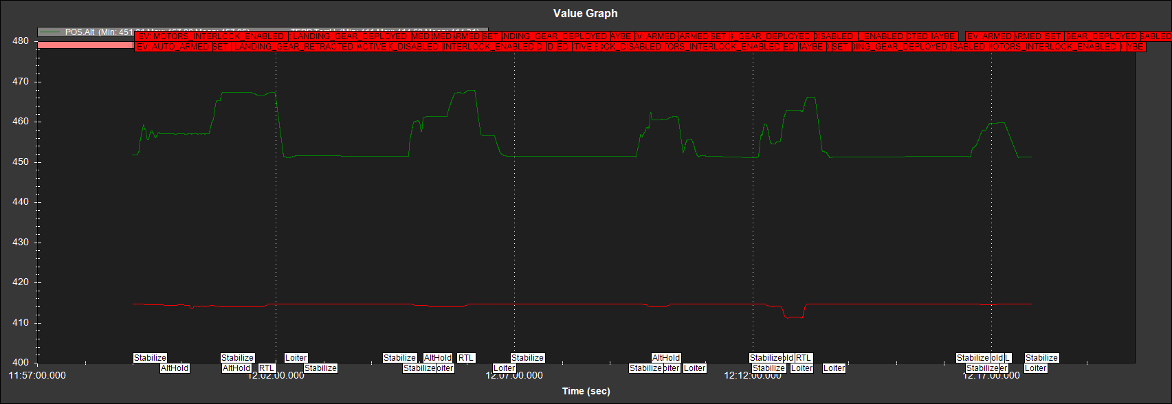

I’m trying to use an Applanix APX-15 as a GPS, using your GSOF driver, and something doesn’t work quite well.
The problem is related to the altitude. The altitude reported by the APX doesn’t match the terrain height, and when trying to land, the drone tries to descend way below the ground, resulting in a crash.
With any other GPS I tried so far, it works flawlessly. Do you know why the altitude is not correct?
Here’s an example of the altitude reported by a HERE GPS (green) related to the ground (red):
Full log here: HERE4.bin - Google Drive
And here’s another flight in the same place, but with the Applanix IMU. Now the altitude (green) is ~50m above the ground (red):
Full log here: APX15.bin - Google Drive

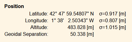

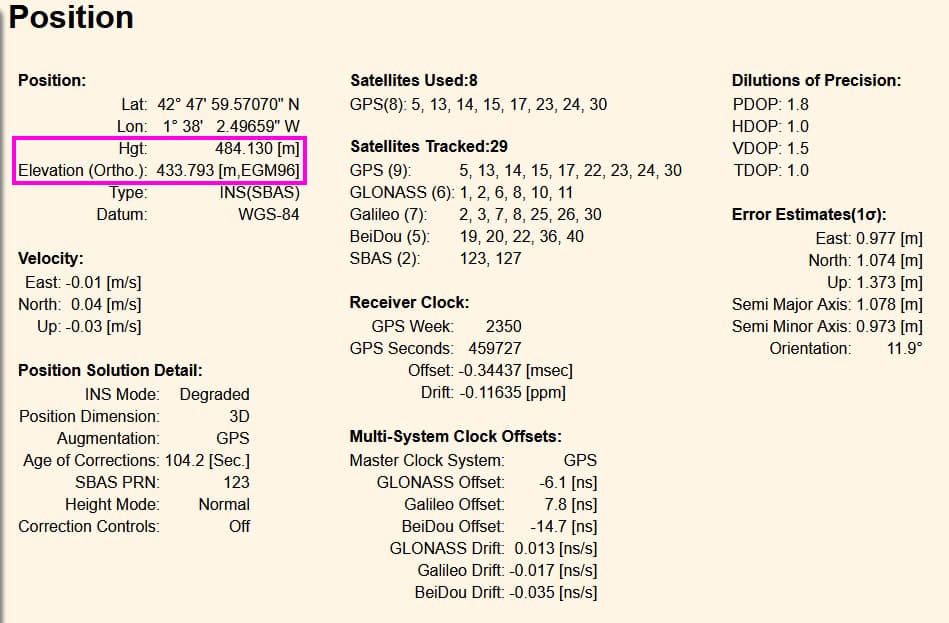

Could this be related to the ellipsoid model? The elevation height shown in the Applanix interface is closer to the real altitude than the height being used by ArduPilot, but there’s also a clear difference in your picture so it probably doesn’t matter.
Nevertheless, the geoidal separation is almost identical to the terrain difference I see when flying.

What confuses me even more is that the retractable landing gear does open and close correctly depending on the height, but when it comes to landing, the drone should slow down considerably when it reaches 4 meters from the ground and it doesn’t because it wants do descend 50 meters more before that.

Yes, the packets that the AP_GPS_GSOF driver is using for altitude is not documented. They are deprecated, and I cannot find information on whether it is MSL or ellipsoid height.
We might be able to figure it out through trial and error. Note, that Trimble has many test flights using the code on master from using AP_GPS_GSOF and no issues.
I’m on vacation for 2 weeks, but when I get back, I’ll be heads down on finishing a new driver for Px-1, which uses recommended packets from Trimble (GSOF 49,50). I’ll keep this thread updated with information. I can dig into your logs then too.
ArduPilot flies generally home-relative, so if the altitude on your HUD doesn’t say 0 when you take off, something has gone horribly wrong.
According to their documentation, the #2 message should provide height from WGS-84 datum and the #70 message returns Mean Sea Level height.
