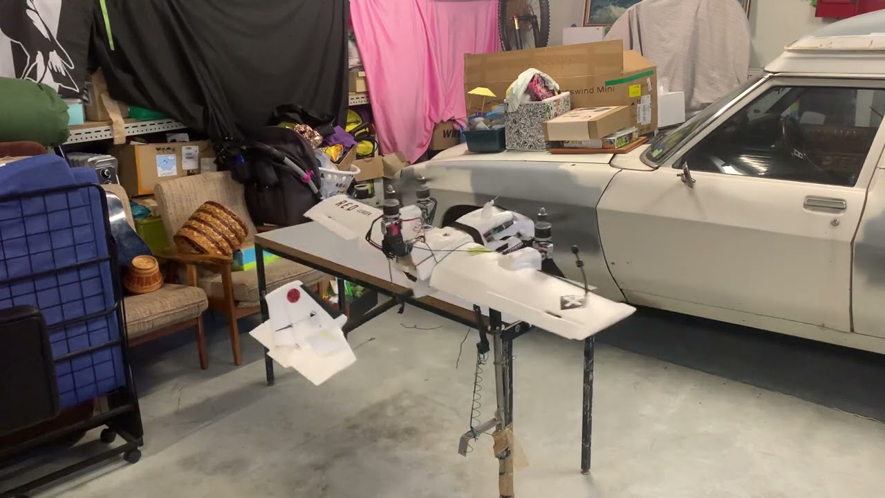

I’m hitting a few walls. Cooked a couple servos… (Elevator servo, AUX servo, and just now the rear tilt servo lost travel in one direction… ) VTOL Yaw and roll controls were responding OK , lately the roll control in VTOL is reversed, I guessed i somehow autotuned it into a bad state as it was maybe working earlier?.. I have no clue what I am doing…

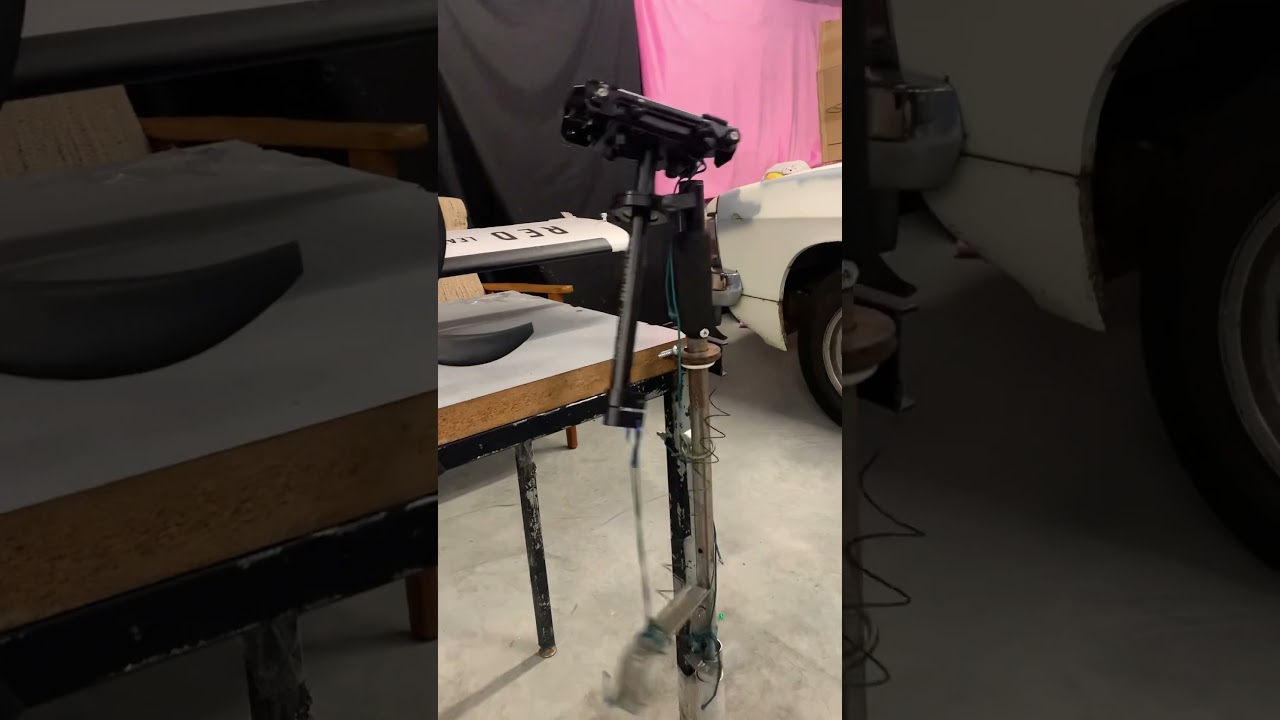

It means it is still in one piece?! Fair point but as a total rookie, im taking some chances, call it insurance for experimental opportunity. When it is stable and flyable and without intermittent control inversion… and runaways… Sure will untie it… appreciate the sentiment but achieving the best tune possible on the gimbal for now seems a reasonable testing ground before sending it to the moon. Made it this far by guessing. Some experienced guidance would really be helpful. And maybe actually succeed. I’ve reached my limit for now. Untying will likely be the end of this project.
Do you mean there are tuning limits due to a gimbal?
Extra weight from the gimbal, the long strings are to prevent rotor strikes on the table top and the un-weighted gimbal tipping over. Gimbal has 8 inches of up-down movement and is spring assisted, totalling maybe an extra 500g weight to the total airframe, equivalent to having some cargo. But within a reasonable range it has completely free movement.
‘Theoretically’ on a gimbal without reaching any of the movement limits - “should” be what to expect off the gimbal? - albeit changes to CG from motors tilting into new positions demand CG adjustment on the gimbal… this is expected.
