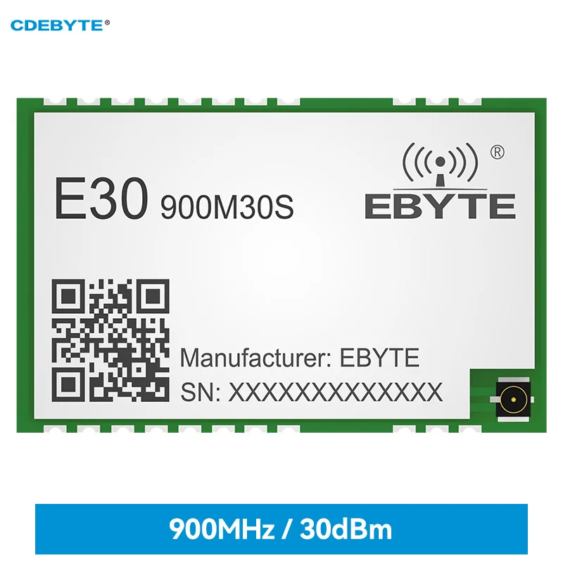

Si4463 RF module, I chose E30-900M20S and E30-900M30S with SPI interface.
E30-900M20S:
E30-900M30S
