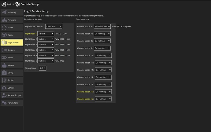

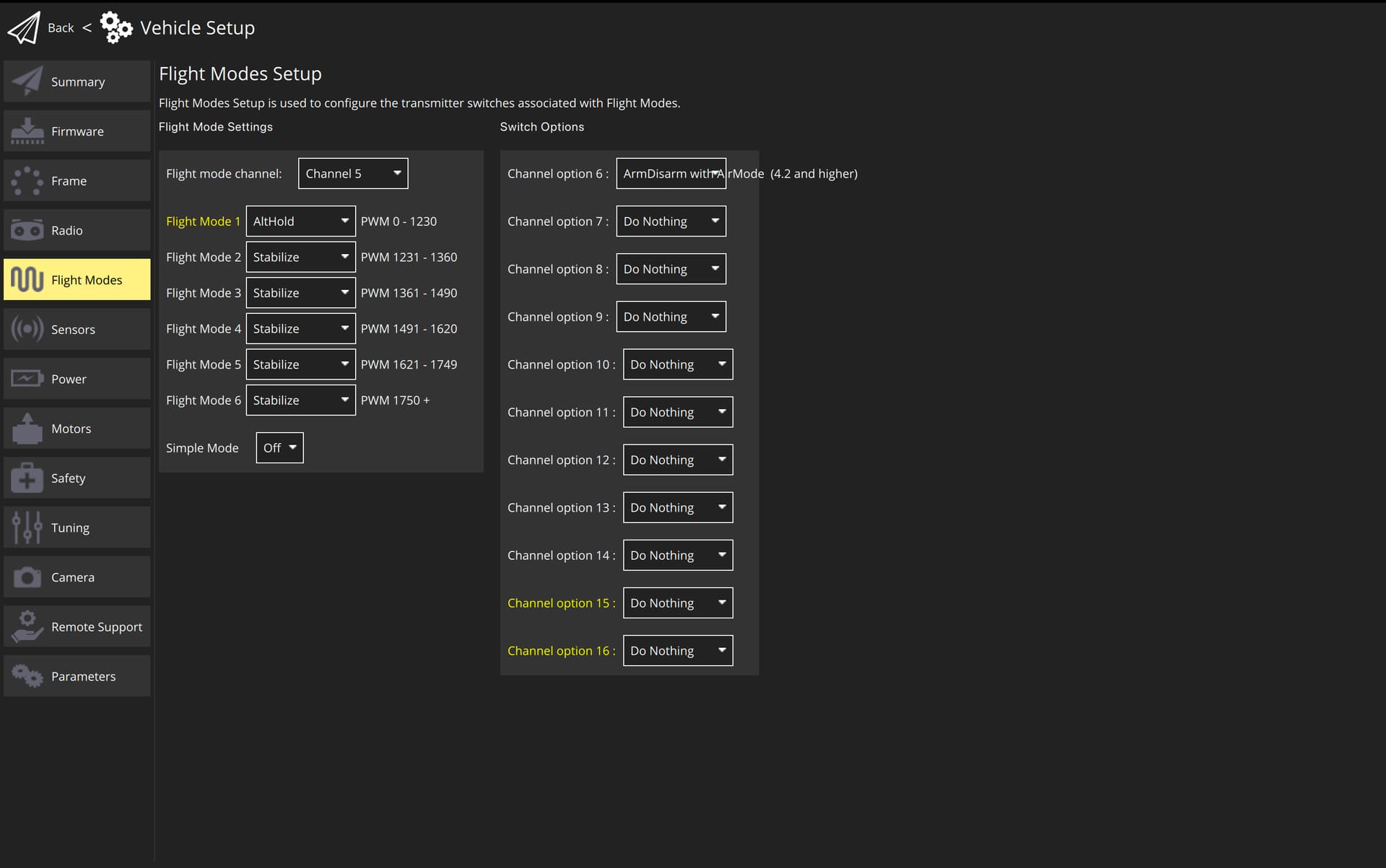

thanks brother, and for other details you asked
flight mode - i am using SA switch, and it has 3 modes i think - defualt, alt hold, stabalize,
default - same problem
althold - same problem
so should i directly fly?, I am scared :joy:.
If the “motor tests” in Mission planner work correctly and the motor order and directions are correct, yes you should fly.
If you are unsure if you did all the steps correctly and want a step-by-step guide and checklist, see this presentation you will learn something.
“default” doesnt make sense, there’s no such mode.
Stabilise should give some level of control, but as amilcarlucas said, that is expected behaviour since the copter thinks you are telling it to take off, and so it is trying to.
