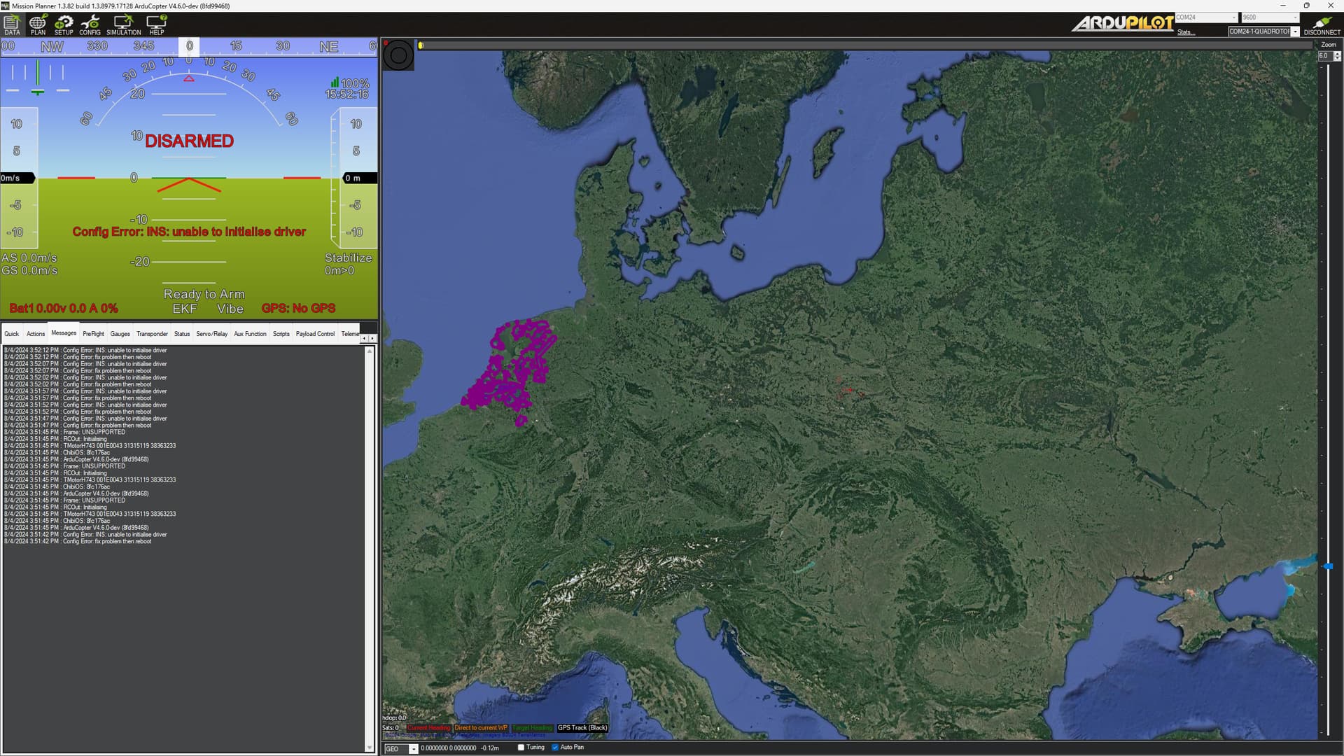

T-Motor H7 Mini - Config Error: INS: unable to initialise driver
I just tried it, still the same error
That is a count of SPI devices, not an indicator of which bus they are on.
Yes, it’s count. The IMU mounting location might be SPI1 (I check the BMI270 and ICM42688P, they are pin2pin compatible).
Is it possible to probe TDK and Bosch IMU instances on the same SPI bus in sequence with macro HAL_INS_PROBE_LIST?
Can you load betaflight and run the cli command “dump hardware” and then post the output
Sure, here it is:

arducopter.zip (841.0 KB)
BF config looks like what I already had. One last roll of the die, after this I am out of ideas
It works! Thanks a lot! What changes did you make?

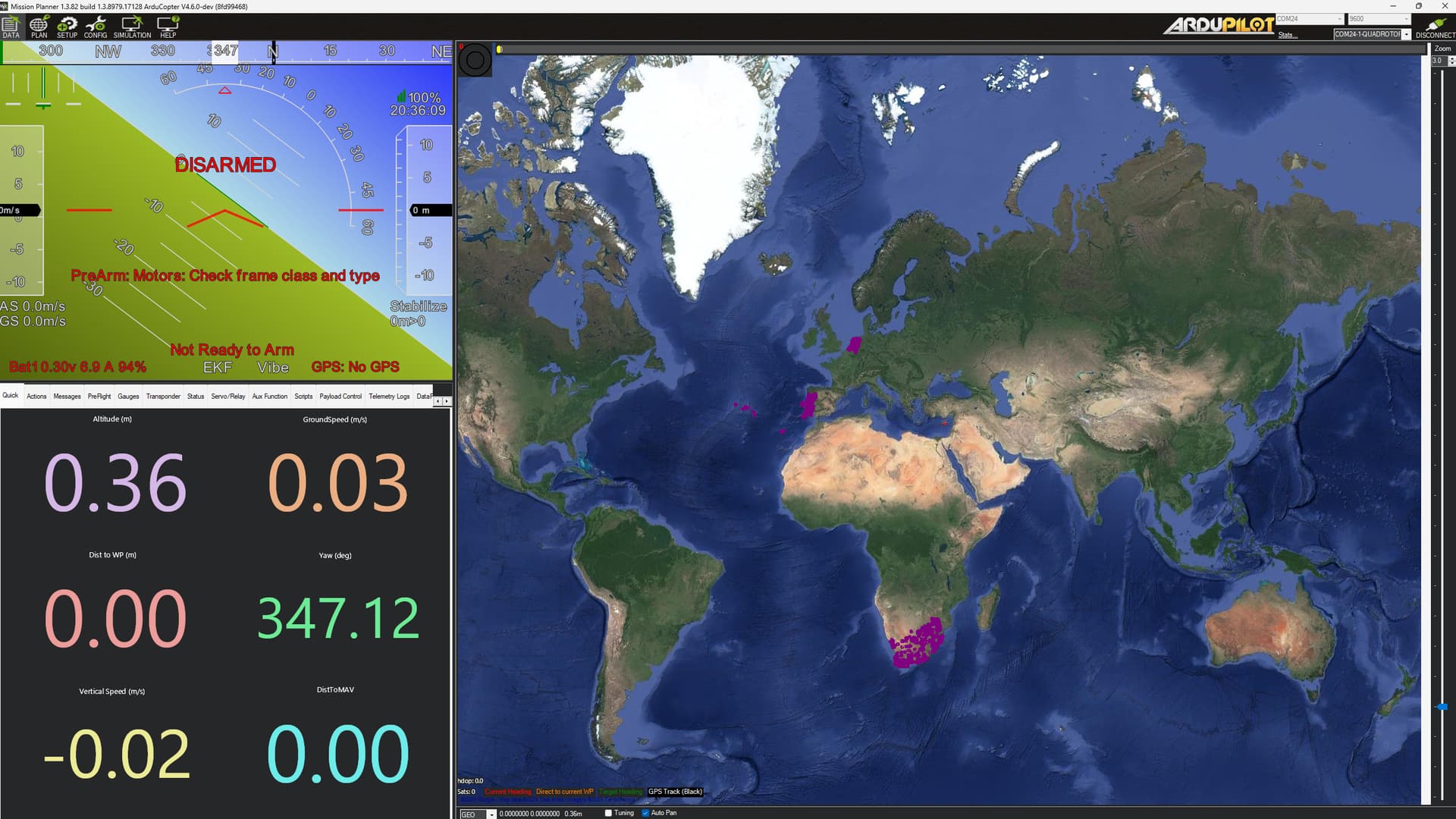

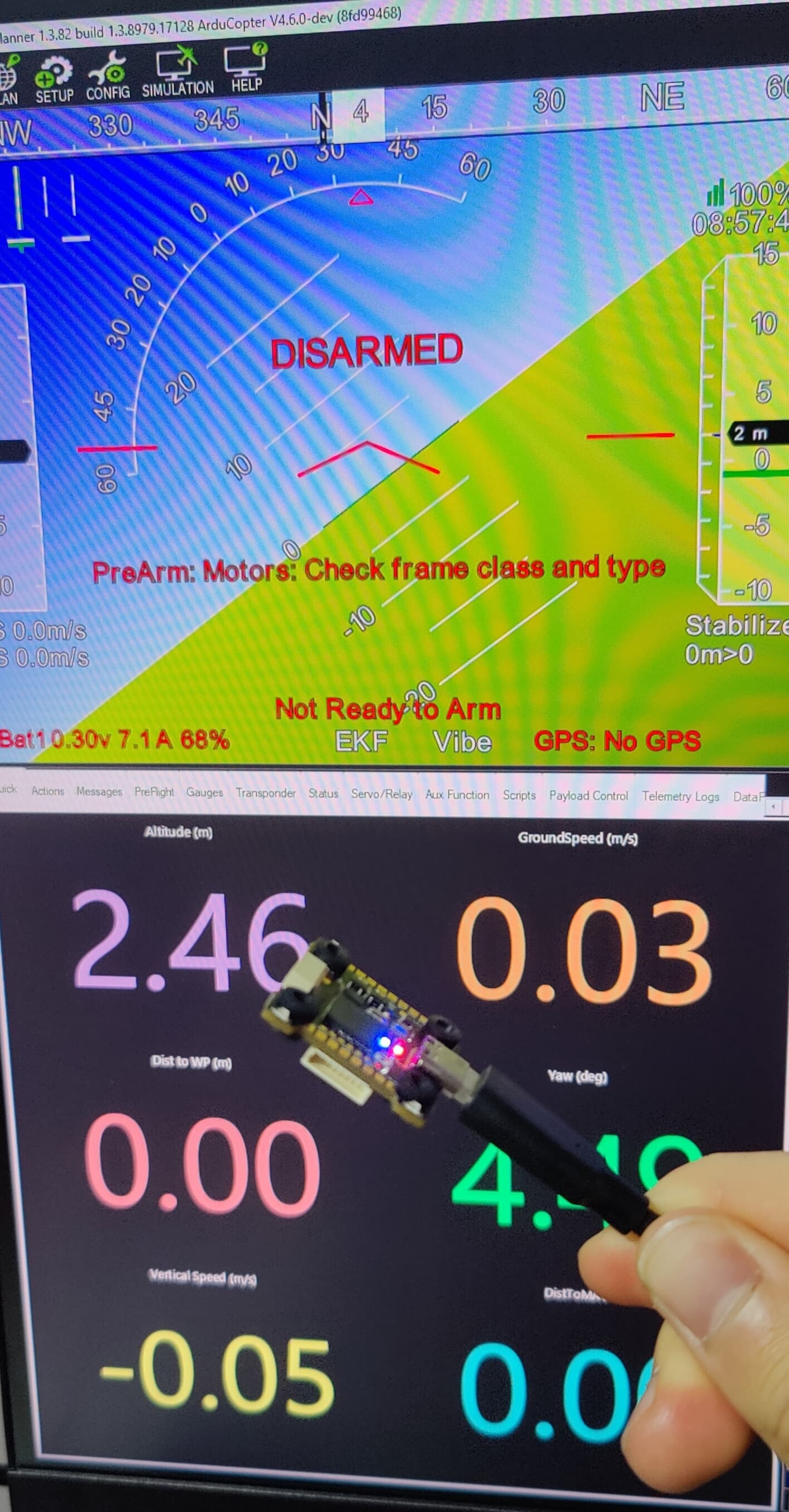

Can you can you check the orientation? The HUD needs to move the right way for roll and pitch
I had to change the AHRS_ORIENTATION parameter to Yaw270 to make the hud align with the arrow on the FC.
Ok so we need to get the base orientation right. I am a bit suspicious that its only yaw 270 - note that if you roll left the horizon should roll right.
Here is a new build with the standard rotation that other boards use. Please reset the ahrs orientation and let me know if it works.
Sorry for the wait, just tested this new build. It’s showing opposite tilt directions (AHRS was set to 0)
Here is a video
Ok, fingers crossed with this one
This one works correctly!
