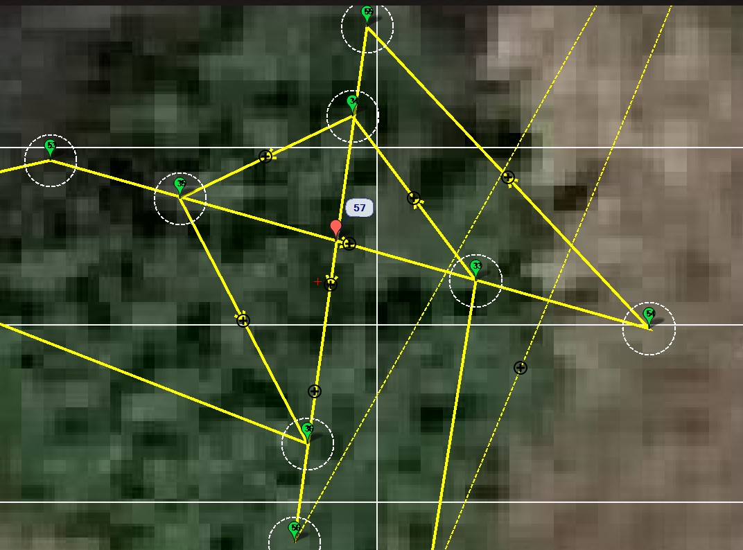

I have found that the easiest way for me to mark trees is to mark 4 simple points (one each side of the tree). I know my mower measures waypoints referenced at the center of the mower in-line with the rear tires. Knowing this, I pull up along side the tree, align my rear tires with the tree, and drop a waypoint. I do this on each side and then download the points to Mission Planner. I never trust a map to tell me the exact location of anything!
After I determine where the tree is located, I insert a DO_SET_ROI WP right on the crossing point of my construction lines. The ROI WP gets displayed in red and I use it (bottom tip of the tear drop) as the center location of the tree. I always worry about how accurate any WPs taken under a tree are located, but I have found this technique to work very well for me with my trees.
I then save the ROI points and add them to the file where I build the overall mowing plan.
I this case I find the Auto WP – Create WP Circle command to be very helpful.
