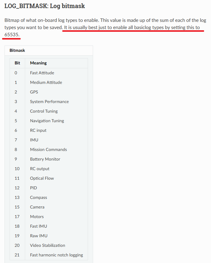

Suggestion 1:
To use the web based review tools, you have to set the right options LOG_BITMASK parameter. The parameter list mentions using “65535” as a default.
This doesn’t make sense because it would include both Fast Attitude and Medium Attitude.
My guess this wording is for an early version of ArduPilot where there were fewer options.
Also - the default for LOG_BITMASK when installing the firmware or resetting to defaults is “176126”.

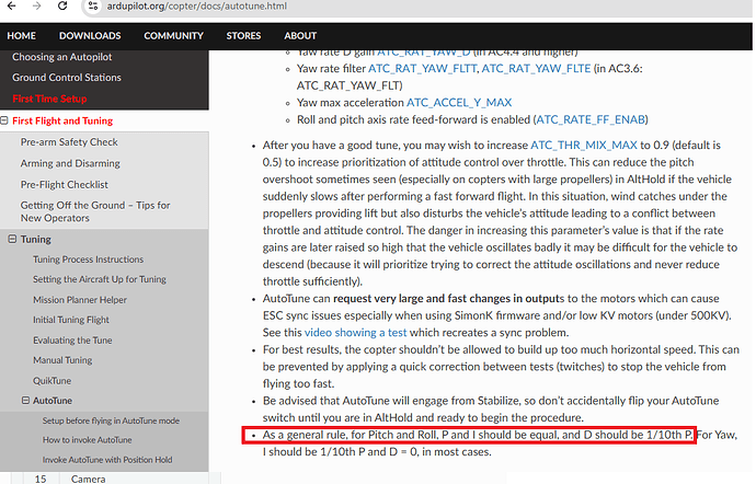

Suggestion 2:
The section on autotune offers a “general rule” that for the PID’s, the “D” should be 1/10th of P.
This contradicts the default PID’s that are set when loading firmware or resetting parameters to default: Pitch/Roll P, I, D are set to 0.135, 0.135 and .0036. Here “D” is only 2.7% of “P.”

Pretty sure that Fast and Medium just use the greater of the two
IIRC that is a two bit field pretending to be two separate fields.
It is a 2 bit field like @LupusTheCanine suspects
What is the correct parameter for LOG_BITMASK ???
Yes but I think the semantics of the two bits are “whichever of the fastest of the two of these is the one that is used” not “Log in the Fast loop AND in the Slow Loop”
Normal binary semantics apply:
00 slow frequency
01 a bit higher
10 higher still
11 the fastest

I see. My info was limited to just the ATT message, but I see how many other messages are affected by those two bits.
For reference the table in this section
