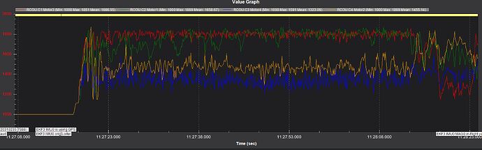

I plotted 3S RCOUT:
And 4S RCOUT:
4S throttle is on average about 100 less than 3S but in my amateur view, the problem seems to be a motor power discrepancy. The motors cosmetically are identical but in reality one needs much more throttle to fly. What do you think?
It’s showing a large mechanical Yaw bias. Not sure how that can happen with that frame. Are the props in good shape?

All arms are rigid and motors too. The arms are short carbon fibre ones. At this stage I think it must be an ESC issue.
That would be quite the coincidence that the CW motor ESC’s are different than the CCW motor ESC’s. But you are using PWM so try a ESC calibration anyway.
I did a calibration and it did help because now I think about it, the motors had a habit of having different minimum spin voltages.
