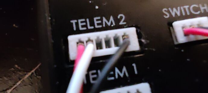

Good day, I would like to be directed to management for help. The connection: connect the SRXL2 port directly to a UART did not work. I am stuck unable to move past radio calibration.

What UART did you connect to?
Did you set the follwing parameters: (x = the number of the UART/Serial port you’re using).
    SERIALx_PROTOCOL = 23
    SERIALx_OPTIONS = 4
    RSSI_TYPE = 3
Remember that any changes made to serial ports only take effect after a reboot of the controller.

thank you for your response. I went to the UART (Telem2)
because I am working with a pixhawl 2.4.8, I was told to go from the SRXL2 to a UART (e.g. Telem1 or Telem2). I had to make a cable because i could not find one to buy for some reason and I tried both UART telem 1 and 2 with no change.

Those parameters would be correct for any type of controller. You just need to adjust the x value for your UART. In this case it would be SERIAL2_.
Be sure you have it wired per the instructions that Andy linked earlier in this thread.

  1. We were working on the Spektrum AR8010T receiver with the Pixhawl 2.4.8 and we wound up connecting it from the Bind/Prog/SRSXL2 to telm2 ( see picture attached). I rebooted the fight control and this did not make any difference in resolving my problem.
    using SERIAL2 as the port:
SERIAL2_PROTOCOL = 23 (RCinput)
SERIAL2_OPTIONS = 4 (Half-Duplex)
RSSI_TYPE = 3

Can you show the other end of the connection? Which pin on the UART did you connect to?
thank you very much. Here are the pictures. It is going to Telem2.
Here is one more picture:

That’s not an 8810T its a 6610T. I suspect its a listen-only device, you need to use this support to get it to work - Support SRXL2 listen-only devices by andyp1per · Pull Request #14341 · ArduPilot/ardupilot · GitHub. So try setting the bit in RC_OPTIONS and change RC_PROTOCOLS to be SRXL2 only.
