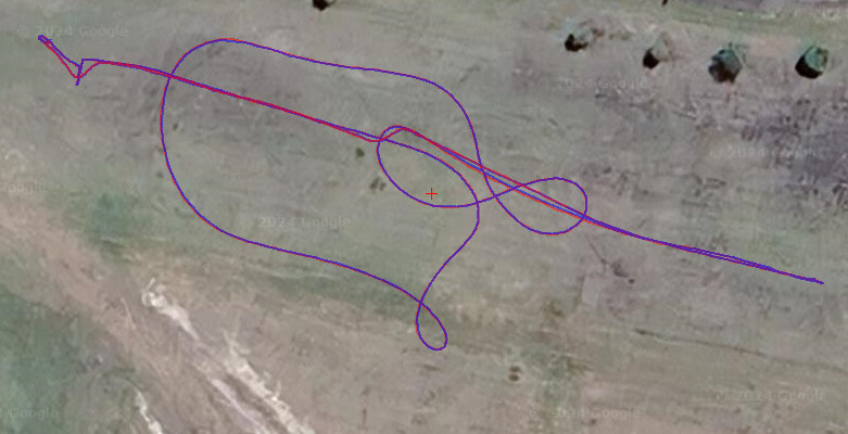

Adding my latest experience with Smart RTL and interested to hear others experiences.
This was in Copter 4.5 and I’ve just been testing in 4.6 Beta too, Cube Orange.
Two different copters.
  1. When SRTL was initiated the copter just sits there for a couple of seconds and on multiple occasions I’d just cancelled SRTL by choosing a different mode - assuming SRTL was not working.
  2. If we wait long enough the copter moves off and starts SRTL but it’s moving at about 1m/s (or similar) and is so slow the copter would definitely run out of battery.
  3. Changing WPNAV_SPEED to something other than a neat 100 has made SRTL a bit more usable. I set it to 1111m/s and SRTL works a bit better now, doing a believable speed between intersections.
  4. The processing is slow, as if the processing of the collected points is not even trimmed until SRTL is activated, causing the copter to wait sometime before any intial movement. It seems the path is not calculated in advance, since the copter moves along one leg, stops and waits, then moves along another leg, and so on like this until it reaches the take-off point.
  5. We did normal flight with plenty of variety for 90 seconds then engaged SRTL. The copter sits for a couple seconds or so before moving then SLOWLY retraces the (correct) path but pauses for about a second at each intersection or leg. It took about 123 seconds to complete the SRTL.
I had an idea SRTL would be trimming the SRTL points during normal flight, rather than waiting for the return journey. Even so it was slower than I expected and much more stop/start - definitely not continuous.
There seems to be an old WPNAV_SPEED bug or similar, were values like 1000 , 1200 and similar severely affect SRTL.
My related parameters are all default or close to it:
SRTL_ACCURACY,3      // up from 2m
SRTL_OPTIONS,4       // ignore pilot yaw
SRTL_POINTS,400      // up from 300
WPNAV_SPEED,1111     // was not effective at all when using 1200
Happy to be corrected, informed or otherwise on any aspect.
I’ll look at the code in my meager capacity and see if I can spot anything and raise an Issue.
This SRTL weirdness appears to be related to WPNAV settings, which are all defaults in my case except the WPNAV_SPEED.
According to code and descriptions, SRTL does trim the path as it goes. I can see in the log the number of points goes up and down as more are added then the path is trimmed.
When invoked SRTL feeds waypoints into WPNAV like guided mode.
The problem appears to be the copter is not getting up to any reasonable speed, then stops again at the next waypoint before moving to the next waypoint. So sure I can alter the behaviour with WPNAV settings, such as the jerk, accel and radius, but I would have expected SRTL to work with defaults and provide a smooth continuous flight path.

Just tested: SRTL works as expected, I think the issue was with OA_TYPE,2 - set it to 0.
SRTL reacted almost immediately and followed the trimmed return path smoothly and perfectly without pausing at any waypoints.
I did adjust a couple of PSC and WPNAV parameters slightly for some improvements that are part of normal tuning, but none of that should drastically affect SRTL much.
WPNAV Speed on a tuning knob (Ch6) did not affect the speed of SRTL, it operated at the set WPNAV_SPEED, given the navigation parameters and distance between waypoints.
The only thing to look out for would be your takeoff and the SRTL landing. If you had messed around with the takeoff, then SRTL will do exactly that in reverse. As the copter gets very close to landing in SRTL it may be best to switch to Loiter mode and take over, or hit your Land or RTL mode switch. That will allow the copter to land more definitively and disarm sooner.
You can see the outbound path going all over the place then out to a point. SRTL goes basically straight down the middle in this case - the SRTL path appears more red.
WPNAV_RADIUS,200 cm
SRTL_ACCURACY,3 m
Max SRTL points used for that flight was 50, which trimmed down to 46 at the time of engaging SRTL.
A much longer flight peaked at 119 points, so the SRTL defaults are probably good for nearly all cases but the longest most complex flights.
