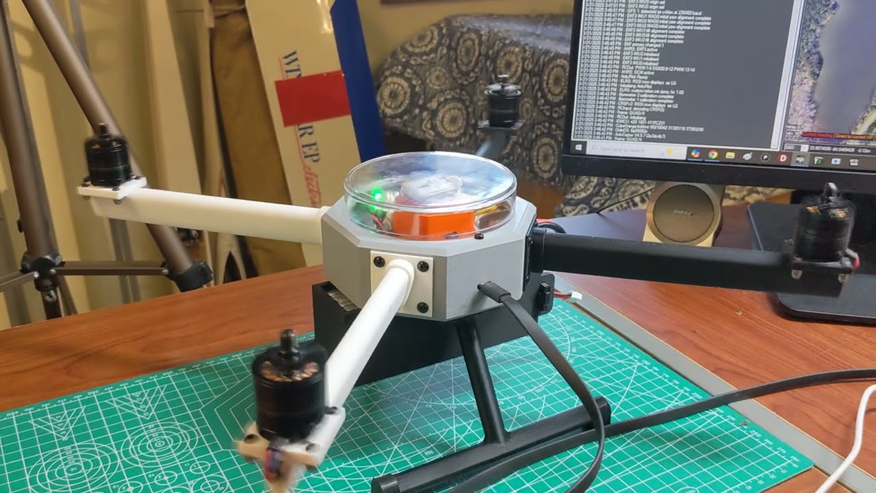

I’ve installed my first ESC with AM32 - It’s a Skystars KM55A.
The quad with this ESC shakes violently when running the motors up in Stabilize mode without the props. I’m using BDshot on this ESC with a Cube Orange and T-Motor 2216 Motors.
I have an almost identical quad using a T-Motor ESC with BLHeli32, Holybro 6C Mini, and SunnySky 2213 motors. This quad behaves normally when running up the motors in Stabilize without the props. No vibration or shaking.

As extra info - here’s a video of an “all motors” Motor Test at 60% - no wobble.
During motor test the esc’s are just commanded to a fixed value.
During stabilize the FC tries to control the Drone by varaiation of the thrust of the motors. But this cannot work without props. On increasing power the FC assumes some reaction which is not coming as the logical back loop is brocken.

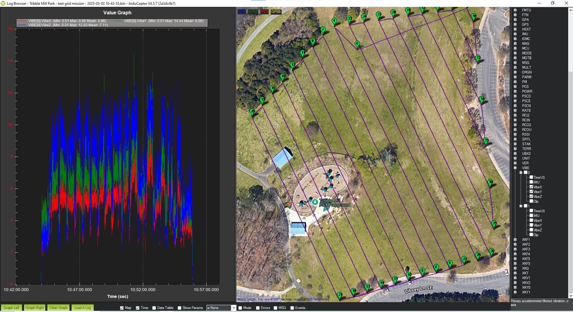

On my first build with this frame where I’m using a BLHeli_32 ESC, the vibes were really low on this test mapping mission.
There are a few other differences besides the ESC.
This copter with the vibration problem is using a Cube Orange. The earlier one is using a Holybro Pixhawk 6C Mini.
And this copter with the vibration problem is using T-Motor 2216 motors with 10" props. The earlier one is using SunnySky 2213 motors with 9.5" props.
Here’s a video of the first copter in final landing phase on the test mapping mission: https://youtu.be/213TqCpgJik

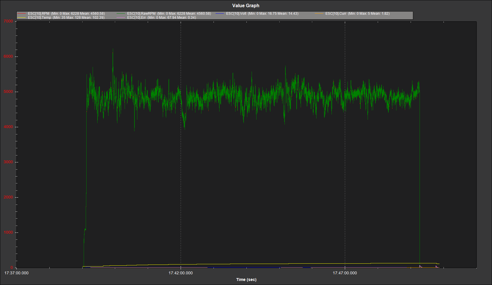

One other thing I’ve just discovered when digging through logs regarding my apparent ESC failure due to high temperature. Looking at my logs from copters with BLHeli_32 ESC’s, the only data being reported from the ESC is RPM. My guess is to get the other data you have to use the telemetry port on the ESC.
AM32 on the other hand reports: RPM, RawRPM, Volt, Curr, Temp, and Err. At least on my Skystars ESC running the latest stable release of AM32.
