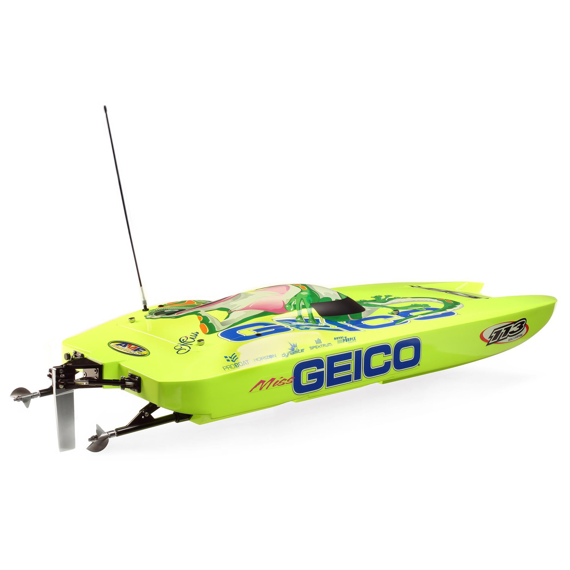

I’ve never heard of this “reversing issue” so I wonder if someone could explain it to me. My guess is the reversing problem appears on frames like @meholden’s (see above) where there are two rudders, each directly behind a motor. When turning at low speed one motor may spin in reverse and pull water through one of the rudders in the opposite direction to the way the boat overall is moving and so the rudder is essentially pointing in the wrong direction? I guess to work correctly the rudders would need to move independently?
If this is the issue then the “Miss Geico” (pic below) might be unaffected because the rudder and motors are separated.
I have only ever seen it in steering mode 3 where there is a conflict between the direction the rudder is trying to rotate the boat and the direction the motors are trying to rotate the boat but only when reversing.
