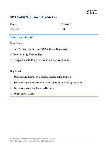

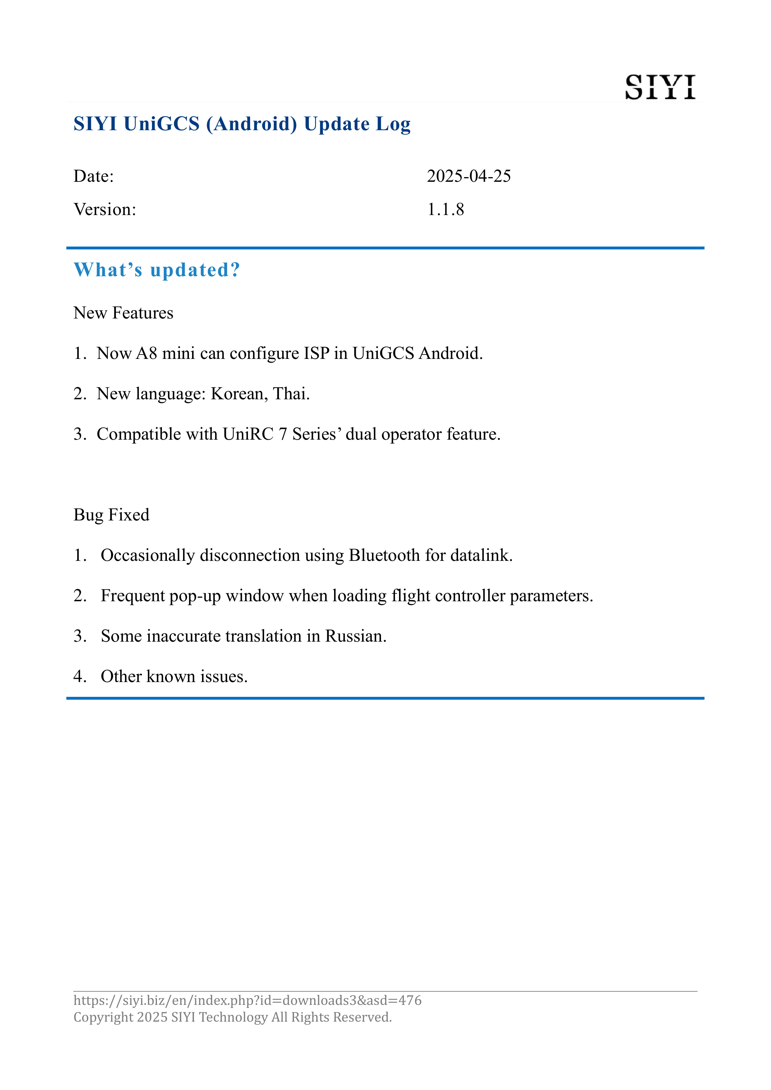

UniGCS Android v1.1.8 Update Log
2025-04-25

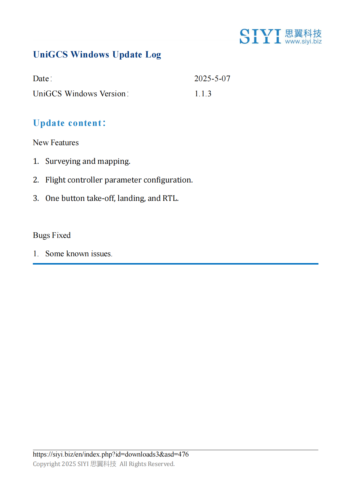

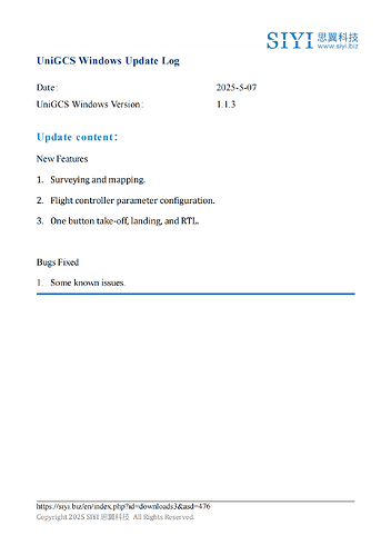

UniGCS Windows v1.1.3 Update Log
2025-05-07
