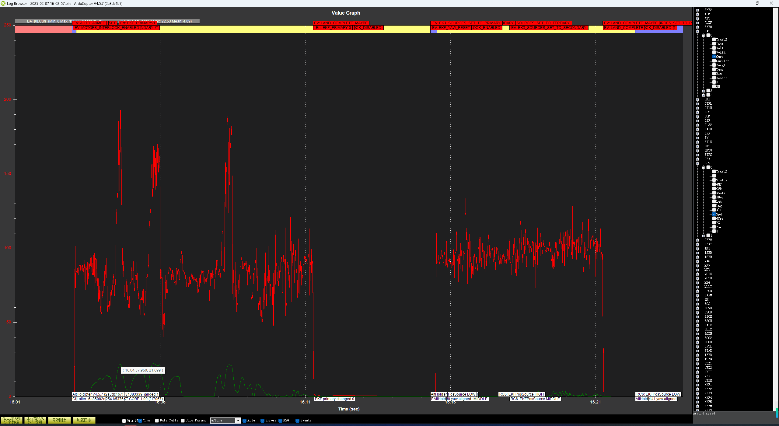

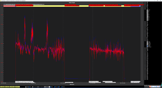

I flew a test flight today
Set BATT1 to SUM Sum Monitor
Set BATT3 and BATT4 as monitors for two batteries respectively
On the MP software, only one battery monitor BATT2 can be seen to be turned off. Normal display of battery current, voltage, and remaining capacity.
And set MOT_SAT_CURR_MAX=120, set MOT_SAT_CURR_TC=1
After testing, MOT_SAT_CURR_MAX=120 did not have any effect. When my plane reached 20 meters or more per second, the maximum current could reach 190A and it lasted for a period of time.
May I ask if there is a setting error or if the MOT_SAT_CURR_MAX=120 option does not work and does not lower the throttle to 60.

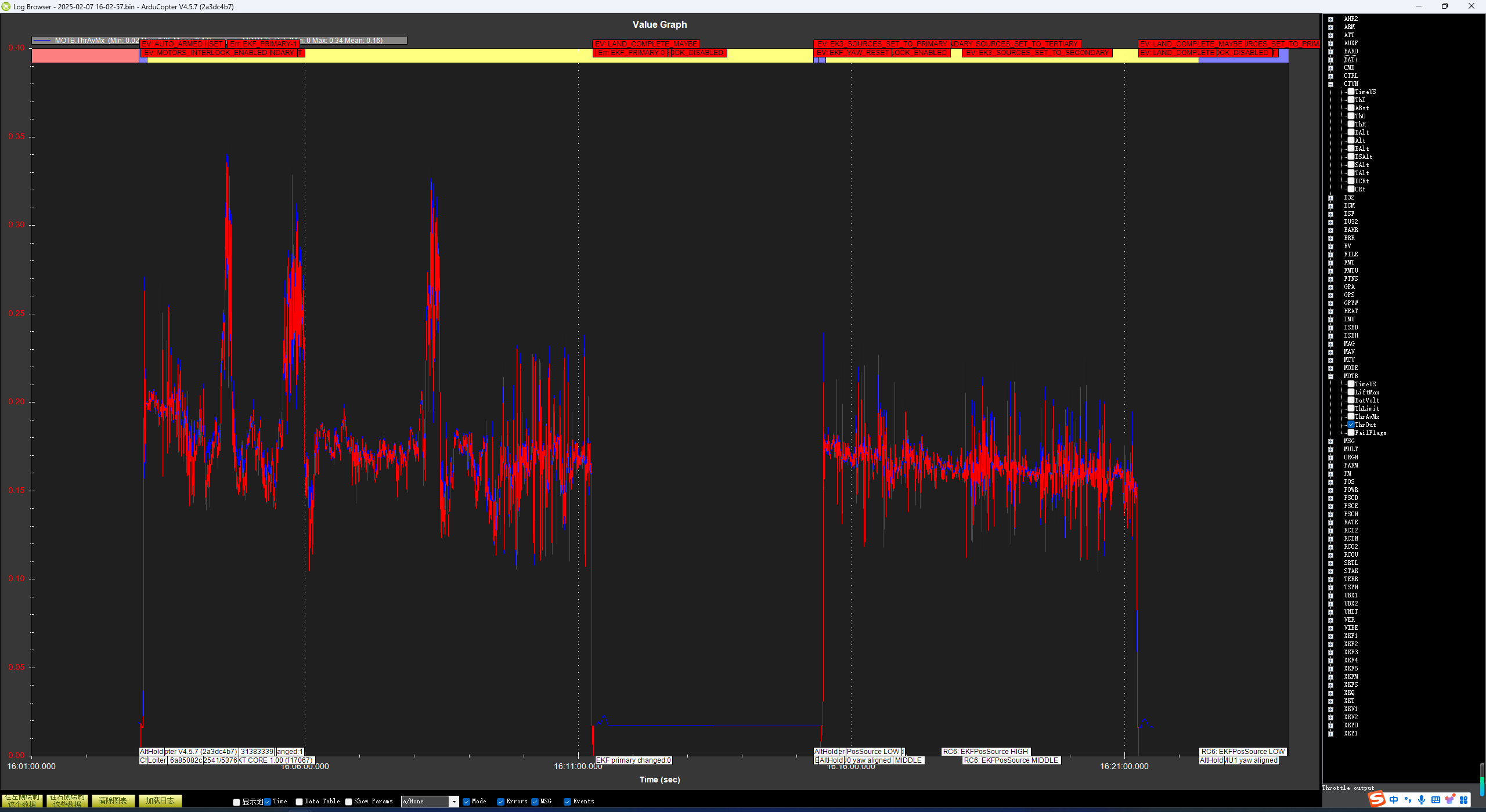

The following file contains all of my settings
202527号改飞机反应速度增加电流监控(电流监控好像没左右)回来改了起飞油门.param (22.8 KB)
According to the introduction on WIKI, the throttle is lowered to 60% after the current is set to be greater than 120 amperes. I read another post description and then looked at my own throttle, which seems to be at its highest of 0.35. Is the problem here? That is, I set a limit of 120 amperes, but in reality, there is still enough power to make my current exceed 120 amperes. So, does this need to be changed to reduce the speed to a certain percentage of the current, or the attitude angle to a certain percentage? If it is not enough, I will continue to lower the current below the limit, instead of lowering the throttle to 60%.
This is just my speculation, and I don’t know the actual code.
