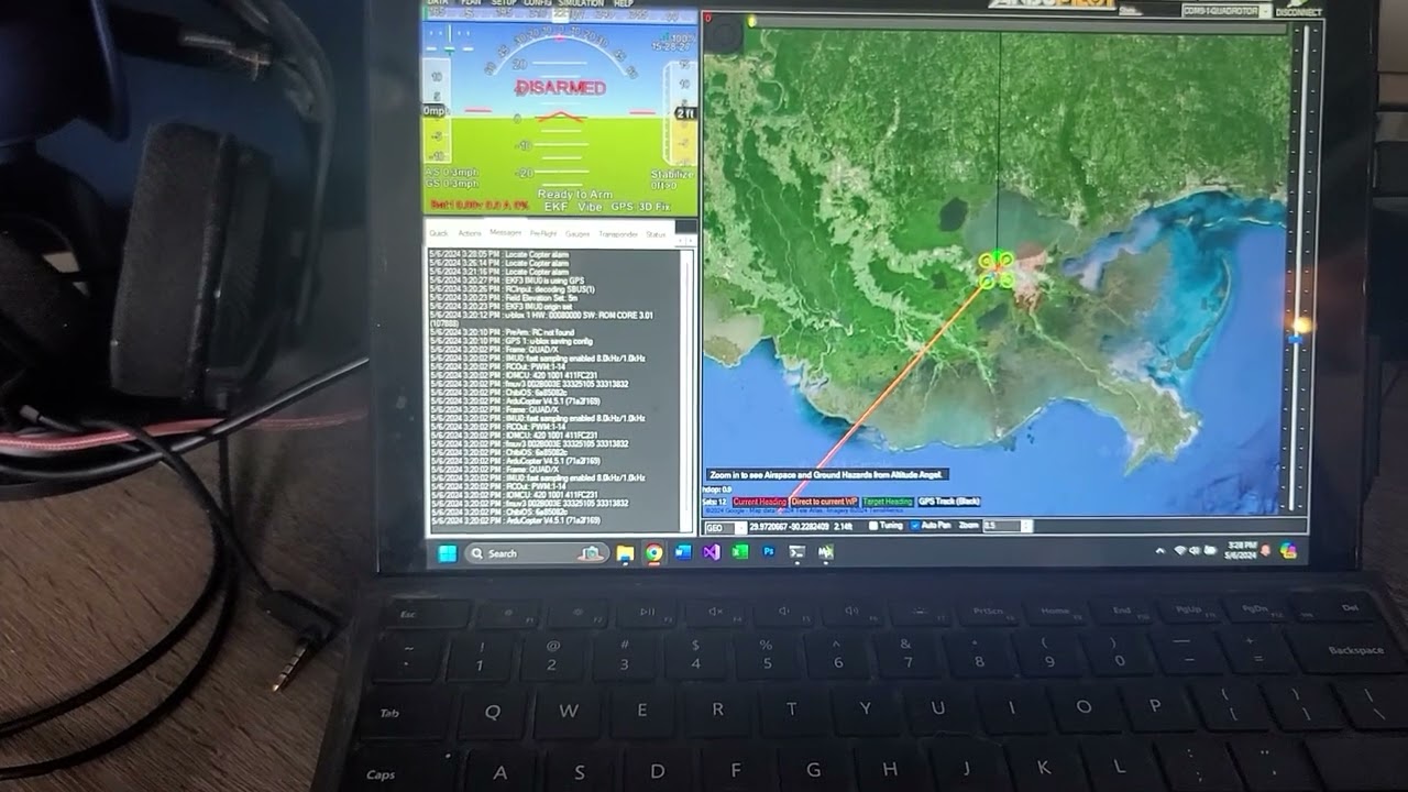

And when I do try to arm with the remote, it just beeps over and over and never does anything. Should I just stick with it? Throttle is down, rudder is at the bottom-right. Holding it to the right alone does nothing.

You should still be able to get it flying. The log looks like Motor Test ran correctly so set BRD_SAFETY_DEFLT, 0 and see if will arm. If not what does Mission Planner say is the problem?
Turns out the beeping I was hearing was just the “Locate Copter” alarm tone. Holding the rudder to the right as directed has no effect. The system doesn’t even recognize a command is being given. It sees the servo and RC signals, but it just isn’t DOING anything with them.
First of all, that was aileron that you held right, not rudder. Rudder is on the left stick. Second, it doesn’t work if throttle isn’t 0. The default arming command via RC transmitter is to hold the left stick to the bottom-right for ~5 seconds.
Third, what happened after you clicked “Arm” in the gcs is exactly what is supposed to happen. You arm the drone, the motors start spinning with MOT_SPIN_ARM rpm and if the drone doesn’t see further input for 10 seconds after clicking arm, it disarms again for safety reasons.
You have the most basic stuff wrong here. You should have been looking at the Radio Calibration Screen while fumbling with the sticks to see what you are doing. When Arming it looks like this:
You’re right about the wrong stick. On my commercial drone, the Air 2S, I have the sticks set up so that right stick DOES control yaw, so I just got complacent. Good catch. It seems to be working now. Thank you for your help and patience.
LOL Beginners gonna begin, my dude. There’s a ton of resources out there competing for validity and it’s easy to not know what you’re doing. That’s why this board exists. Feels bad to have your ignorance to something new harped on instead of helped, but I still appreciate everything. Janno got me hooked up.
