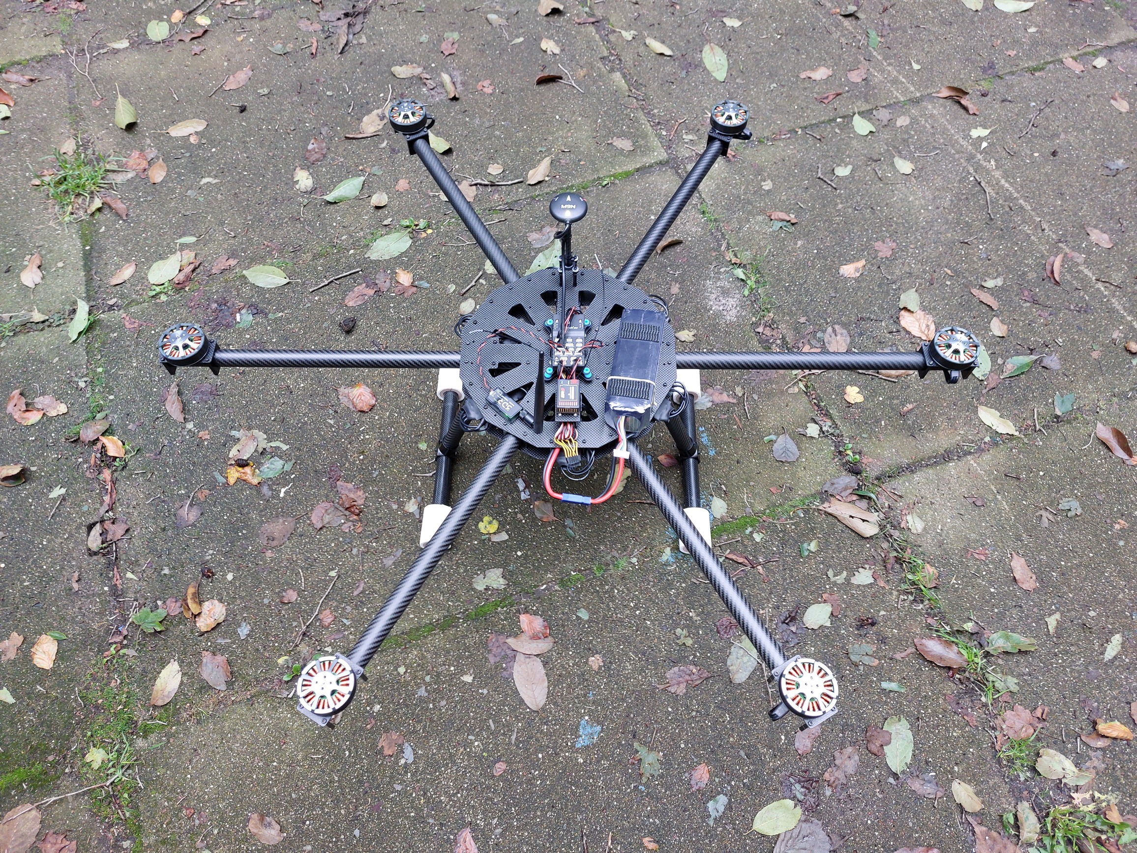

Just check the manual from the PX6X.. I use the PX6C almost the same setup..
