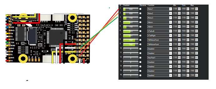

I’m building a Tri-VTOL V-Tail on a Speedybee F405-Wing. The front two motors have Tilt.
I’m new to Ardu, and I can’t quite get my head around the servo outputs.
Do the servo numbers in the ‘Servo Output’ tab, directly reference the S# numbers on the speedybee?
e.g Servo 1 in the config, is servo output 1 on the board?
Like this?
Or is there something more to the mapping that I’m missing?
I seem to have some strange behaviour on servo 5 output. It is set as an Aileron the same as #4, but it isn’t responding smoothly. #4 smoothly responds to be tilting the board left and right (as an Aileron should). But servo 5 will only go to 1100, or 1900, nothing in-between.
Yes. More detail here Speedybee F405 Wing
Pay attention to timing groups when mixing motors and servo’s
Thanks, that helps a lot - Especially the timing groups. I presume the strange aileron behaviour is because its in a group where DSHOT is enabled.
I’ve rearranged the outputs so that the three motors are in a timer group 3. There would be a wasted output if I use group 1&2 as I was previously.
There is a slight typo on the ardu page, S2 is in both group 1 and 2. But the speedybee manual has the correct groups.
